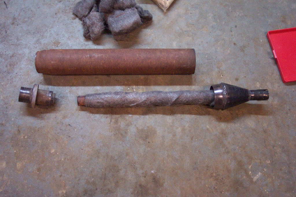

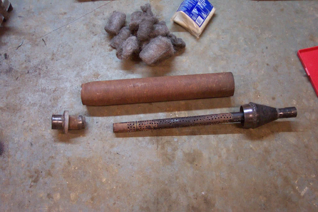

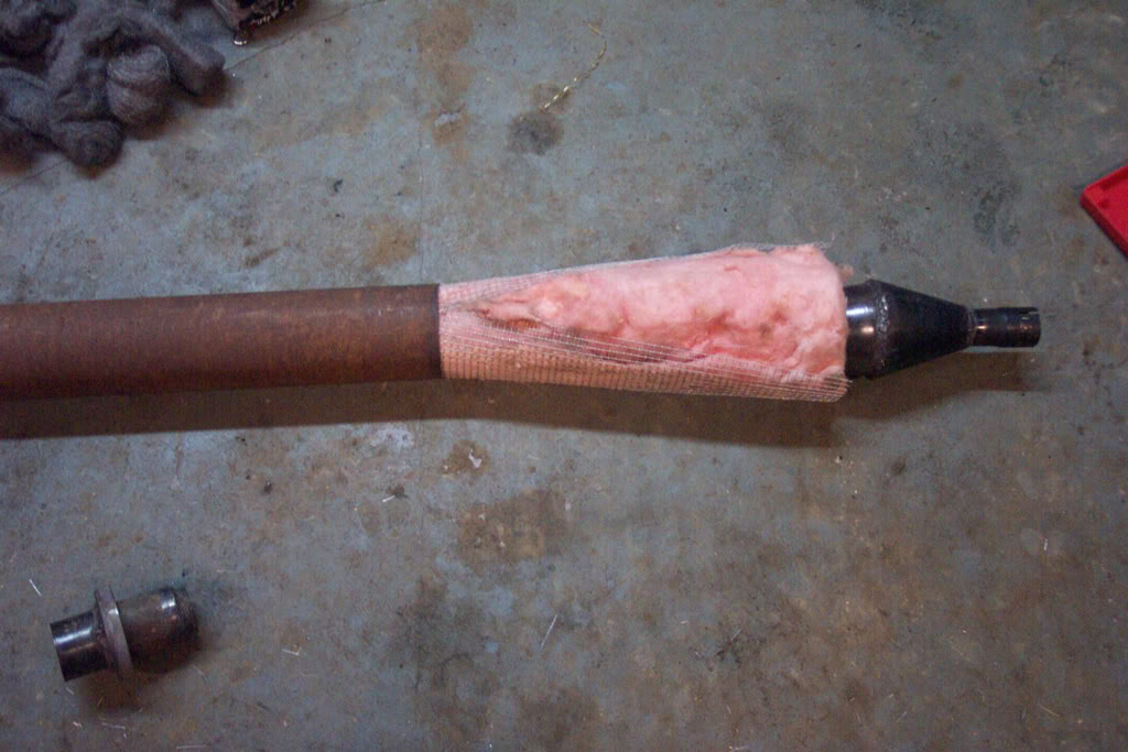

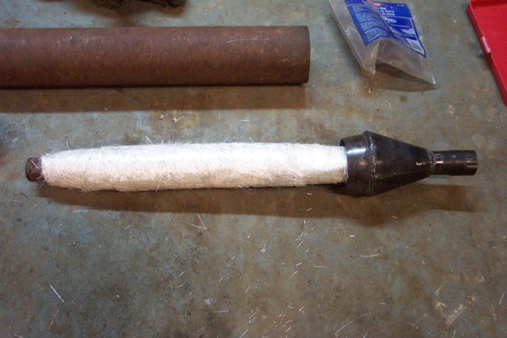

The jet kit, probably. Not a fan of megaphones though. Somebody, somewhere online said to show him ONE dragbike/car or serious racer with a megaphone. I thought about that and couldn't think of any... they all straight, open exhausts. No megaphones. So, what you basically want is a pipe of constant diameter and that diameter and length tuned to where you want your power in the rpm curve. Big and short for high rpm power, small and long for lowend. Once you get the pipe where you want, drill some holes, wrap in fiberglass and incase it in a bigger pipe.
Here's what I did:

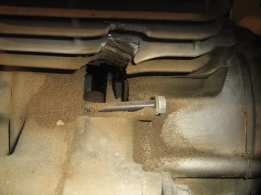

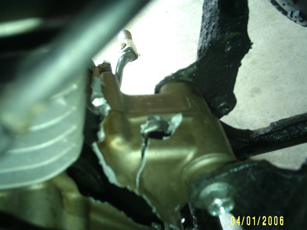

You have the upgraded valve springs right? I have no idea what these engines are capable of, but I'm thinking the rod is the weak link:

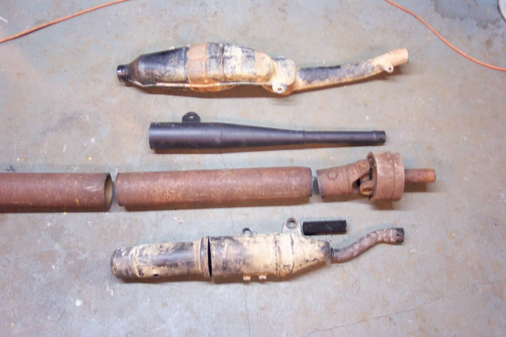

Randy, i recognize the steel wool and fiberglass insulation, but what is the white stuff you wrapped your pipe with in between... I need to replace all the stuffing crap in my exhaust as it was full of oil and filth from a previous owner running it with worn out rings for a long time.
thanks
Old Nov 4, 2010 | 08:46 AM
  #9449
JustRandy's Avatar
Joined: Mar 2007
Posts: 5,227
thanks

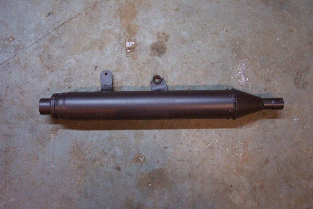

That's fiberglass too, just thicker and not pink. Fiberglass mat its called. I had some laying around from a fiberglass repair job. The steel wool is supposed to stop the fiberglass from being blown out. I don't know... someone said to do that. Ironically, the wool will burn before the fiberglass lol
The sound is deep not "tinny" like the megaphone muffler in the 1st pic. I think that is due to the thicker metal in the driveshaft compared to the muffler. As long as I keep the rpms down, its actually pretty quiet. All that changes when I open it up though. Still wouldn't describe it as loud, but it ain't quiet either. If I could change anything about it, I would make the driveshaft a larger diameter. That would make it deeper and quieter farther up the rpm band.... and of course, let me pack more fiberglass in it.

ic. I had just pulled out the old fiberglass and put in some fresh insulation i had laying around, but its still pretty loud. I was lookin for a way to quiet it down a bit more. The local cop does drive around town from time to time, and in order for me to get out of town to ride to the farm or do any real riding i have to go through part of town. Its a very small town, and im a local so i could probably talk my way out of a ticket, but i would like to just avoid a situation where i would have to do that lol. any ideas to quiet her down short of putting on a different exhaust? what kind of materials can i pack in there and not hurt performance?
