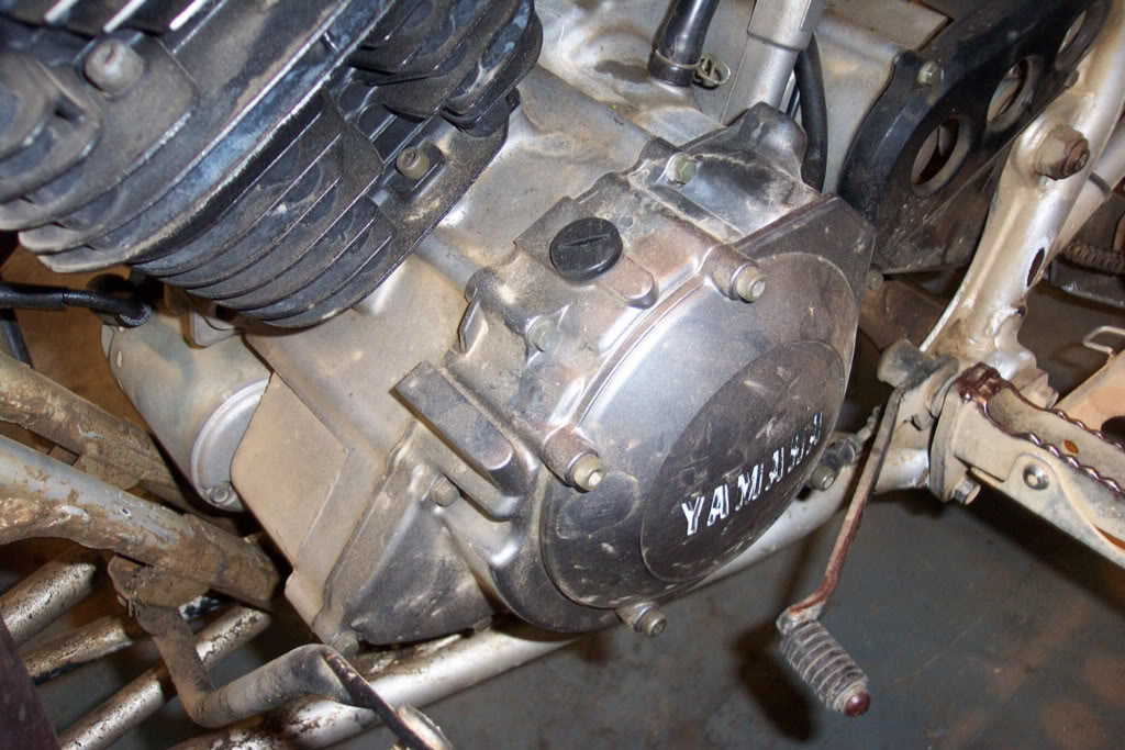

So I am not engine savy by any means. I have noticed a little bit of oil markings around this round rubber plug (on the left side of cylinder head or maybe it's the valves). I have been having some trouble starting the 95 KQ, but once started, no problems whatsoever. I was wondering, from reading, is it possible that my valves might be gunked up with oil? Would this cause the starting problem? What would happen if I pulled that plug? Anyway, I was getting ready to do an oil/filter change and was wondering if this plug would be of some significance during that process. Any help would be greatly appreciated.

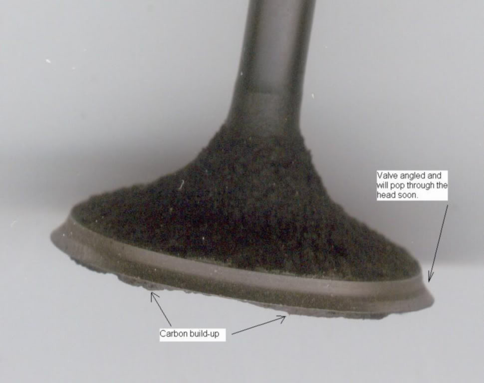

No, don't pull that plug. That's just there to line up the cam with the crank. Your problem is the intake valve is worn out and the lash is gone. You need to loosen up the intake valve lash and you should be riding in no time! But keep an eye on it because it will tighten back up quickly. Eventually, you'll need a new intake valve or it will pull right thru the head!
This is what your valve probably looks like:

If you pay a shop to do it, keep in mind you'll have to pay them to do it again shortly as the valve continues to wear. Once you wear it past the hardness of the metal, it wears fast! This is usually caused by an ineffective air filtration system. IE, dirt is getting in.

You need to get the piston at TDC on the compression stroke, not the exhaust stroke. The piston comes to the top twice per cycle. 720 degrees of crank rotation per cycle.
No, I don't mean the rubber plug. I mean the metal plug with a slot in it on the alternator cover. If there is a plug there, just remove that and line the mark up with the center of the hole. The mark should say "T" or "0".... Not "F" or anything like that. The manual says, "To ensure piston is on compression stroke, rotate crankshaft 1/4 turn past TDC while observing intake valve. If valve movement is indicated, rotate crank one full revolution and align timing marks again."

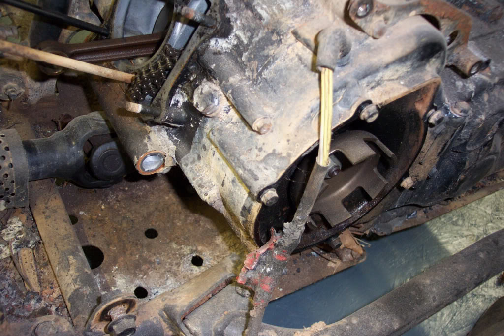

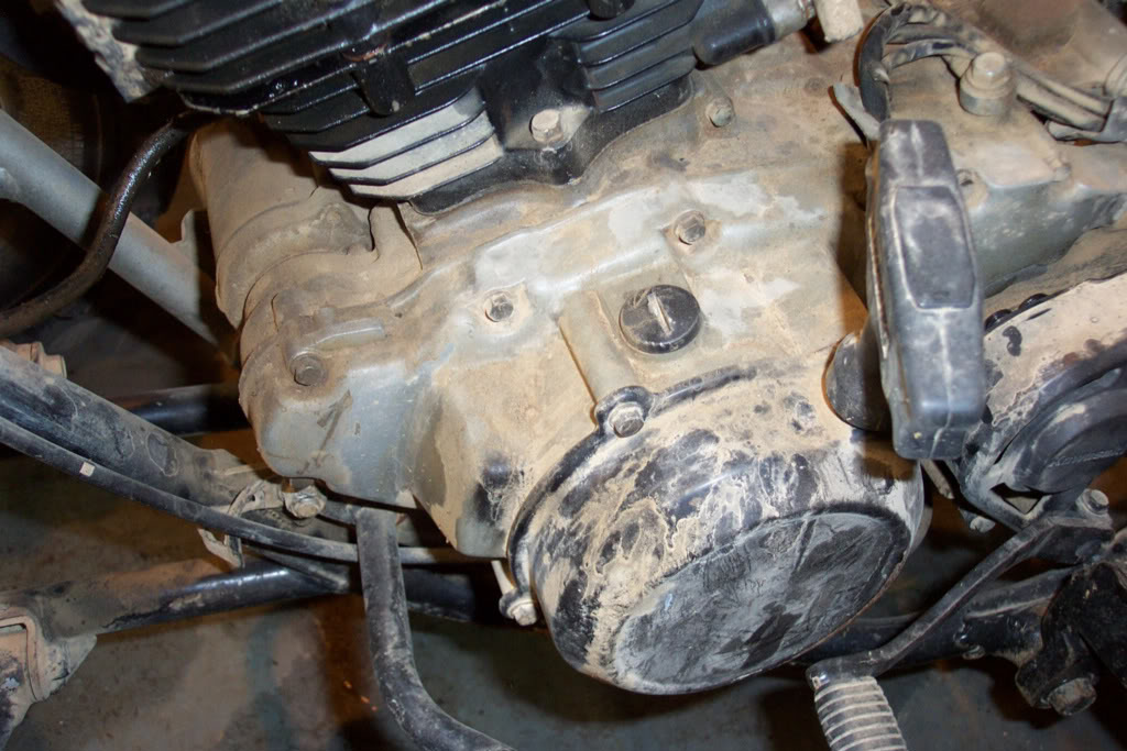

Sorry it took so long.
Here's what the plug looks like on the LT4WD 250, Warrior, and Lakota:
