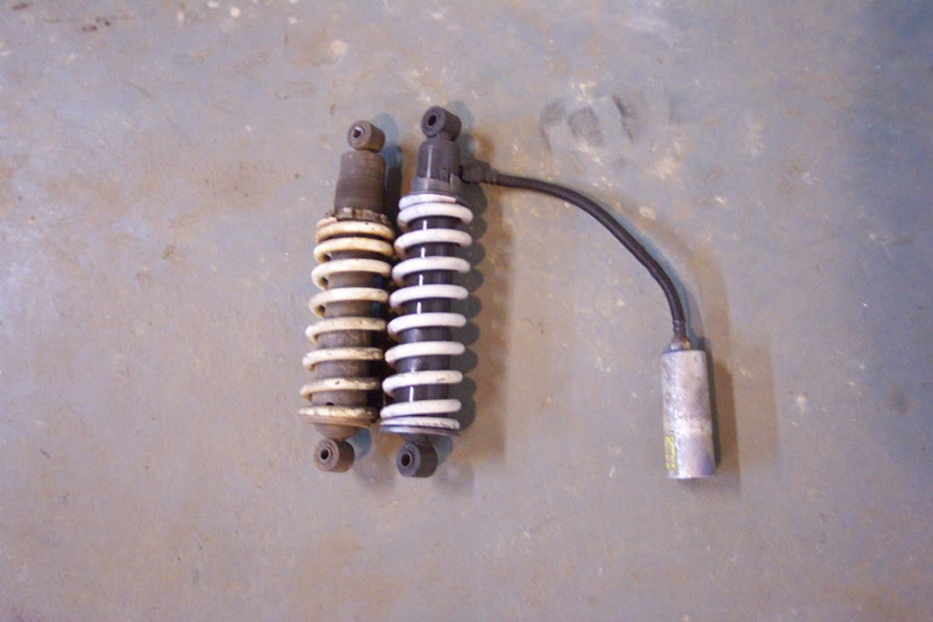

Old Apr 12, 2009 | 01:12 AM
JustRandy's Avatar
Joined: Mar 2007
Posts: 5,227
This is the 230 shock next to the 250 shock: Name:  DCP_2835.jpg
