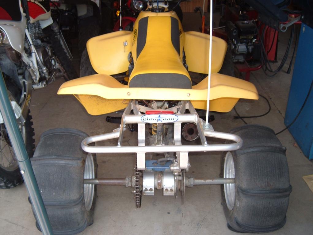

they started using the seats where the back end was real wide in 90, thats a regular narrow seat, unless it has older plastics on it maybe.
Old Jun 6, 2009 | 11:41 PM
lt230sman's Avatar
Joined: Feb 2008
Posts: 1,111
From: NJ
yeah and the swinger uses a round carrier with pinch clamps, and the front shocks look relativaley short. sounds like an 85-86 lt250r to me.
nice find!

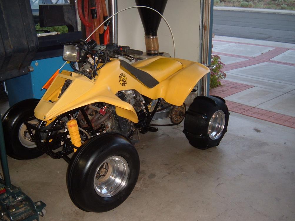

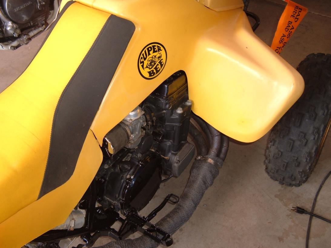

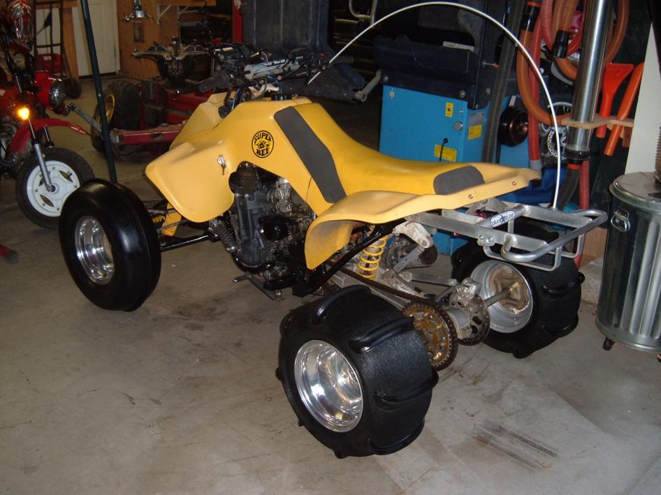

Default 250r
Here are some updated pics. I have been working away on it since I bought it. The 69 Superbee stickers were a must.Troy
Attached Thumbnails Newbie with a street bike powered Suzuki quad-2009_06227500004.jpg   Newbie with a street bike powered Suzuki quad-2009_06227500001.jpg   Newbie with a street bike powered Suzuki quad-2009_0620lt7500003.jpg   Newbie with a street bike powered Suzuki quad-2009_0620lt7500004.jpg
Old Jul 1, 2009 | 08:56 PM
  #17
lt230sman's Avatar
Joined: Feb 2008
Posts: 1,111
From: NJ
mopar? :\
well... 69... eh i suppose...
anyways, thats definatley an 85-86. only they used short 12.38" front shocks. after that, they used 15" units, 87-92. and the difference isnt just in the arms, the upper mounts on the frame are different. as far as upgrades go, talk to works. they will get u set up right for a fair price.
