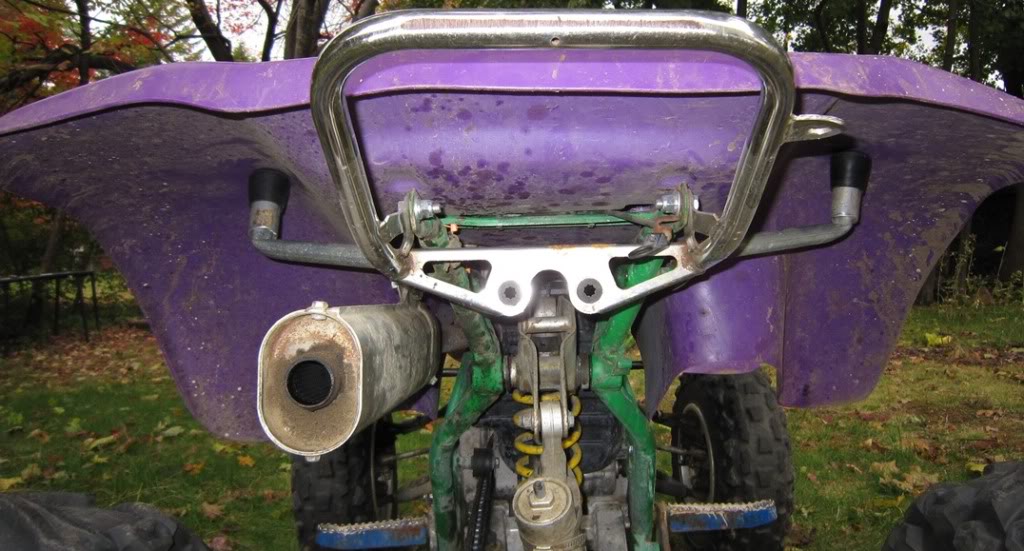

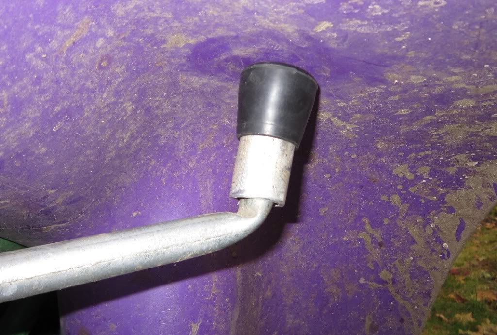

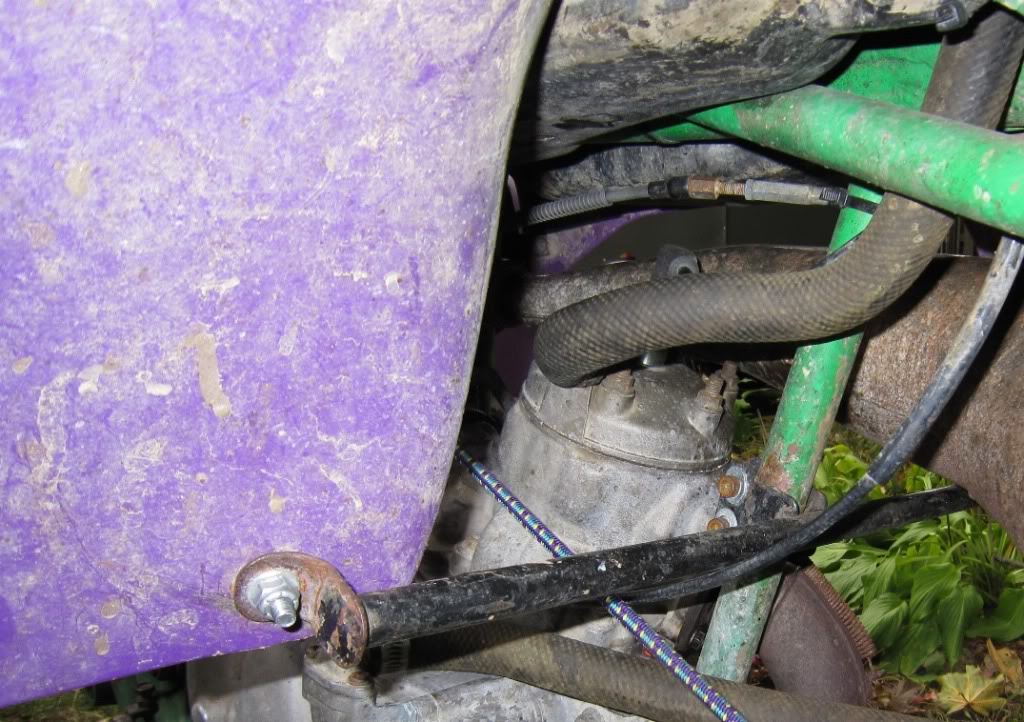

So, I did a little work with the body. I finally got the new grab bar on along with the front fender brace. I did have to add a short piece of ID 3/4" aluminum pipe to the end of the rear fender braces to make the fenders a bit more perky, I then fitted the ends with some rubber feet you see on canes and such for more cushion.

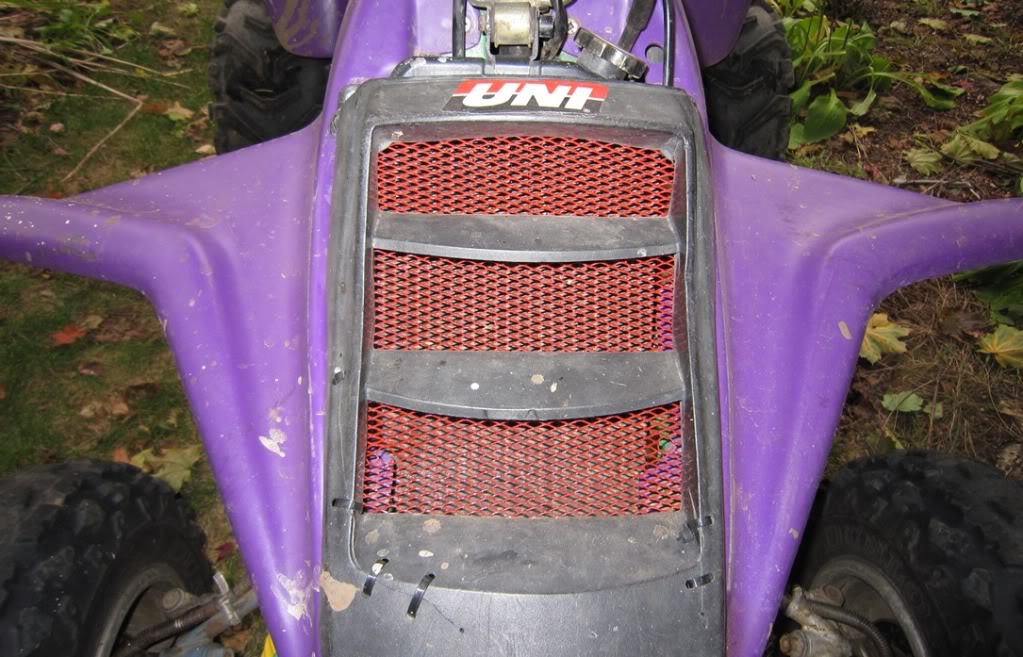

Just for the heck of it I did a quick paint job on the front grill it looks better than rust, I think the red really makes it stand out matching those red bars!

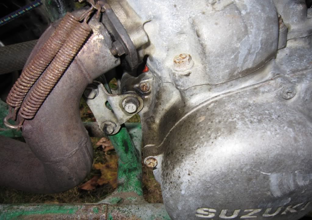

Still battling the leaky exhaust header problem, I even swapped the 3 bolt flange and used the one that was on the spare head I have, it fits snugger but has a weaker spring mount. So this one makes it not drip but spray a fine mist of crap all over the engine!
So I don't know, I think I am missing something here like a gasket or oring? The pipe slides right over the header flange with nothing to seal them but these FMF spring kits comes with 2 orings?? I am not talking about the crush washer inside the head itself I have one of those. I have a FMF Gold Series fatty pipe so am I missing these orings?

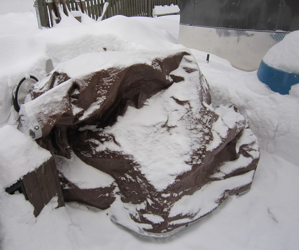

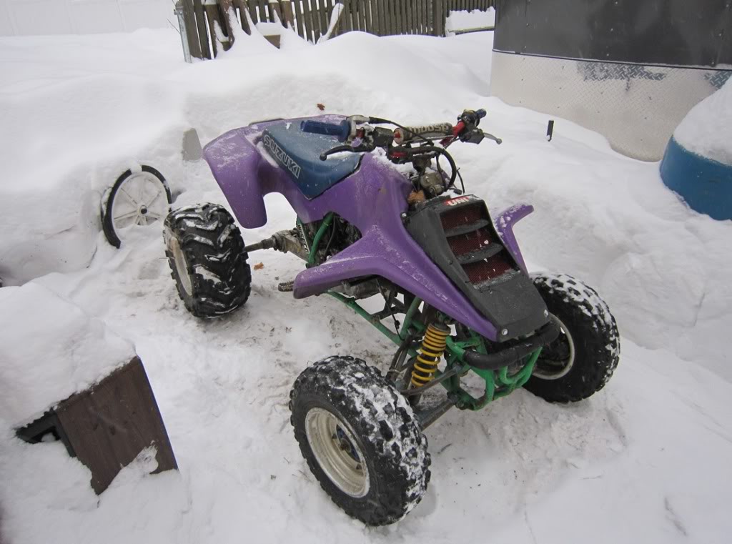

We have several feet of snow here in MA, it's up to the top of the fenders. I forgot it was there and it started getting buried into a snow bank so I dug it out today:
About an hour later... hahaha

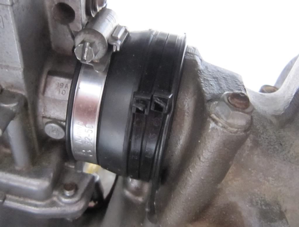

I had to put some gas in the cylinder and put the plug back in for it to start, after all it has been 20F all month and somtimes -5 at night. But I'm having the same problem I did when I put it away, the idle freaking out redlining the RPMs. So I tried getting a tight seal on that intake boot with zipties and pliers which is a lot tighter then I could get with an undersized hose clamp. There is NO air getting in anywhere I can see! If I turn the choke off it wants to die, so I played with the throttle to keep it going but most the times I brought the idle back up it just took off and redlined. It's definitely leaning out because the air/fuel screw is 1 1/2 turns out, and if I go closer to 1 turn out it dosen't redline as much but I had to keep putting it in gear and winding the engine down. I got fed up and pulled the carb but it was as clean and free as a whistle. So I'm wondering if the problem is really something else, can bad reeds do this? Someone said low compression could cause it, like bad rings or a bad sleeve. I wonder if that sound I was previously talking about in my video is a little piston slap and a bad sleeve....

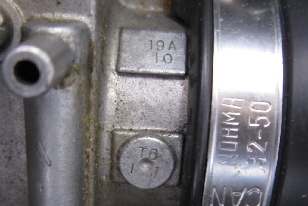

Maybe this is the wrong year carb or something? The markings on it say "19A" with the number 10 below it. Then under that it says "T6" with a 1 under it then a space and another 1.

Possibly a bad base gasket. Just read through your post. The running with the plug wire off is the dreaded death rev. of a 2 stroke, the cylinder is soo hot from being lean it is auto ingiting the fuel. The heat and pressure is ingiting the fuel not the spark from the plug. Usually that's when things go bang cause it'll just rev.out till it blows cause it can't be stopped. A last ditch effort to stop it is to go wide open on the throttle to let cool air into the cylinder. Since it didn't blow or melt down consider yourself real lucky. You need to do a leak down test.

The gasket at the bottom of the cylinder where it meets the cases. I know it's hard to do but I wouldn't ride it till that's fixed. Leaning it out is the worst thing to do to a 2 stroke. Especially if it's revving out like that, it just takes one time for it to go all the way. P.S. you got guts riding out a real death rev. if that's what's happening! A compression test will tell if you have a bad head gasket letting air in but usually it'll let coolant in first. A leak down test will tell you if air is getting in from the bottom end.
