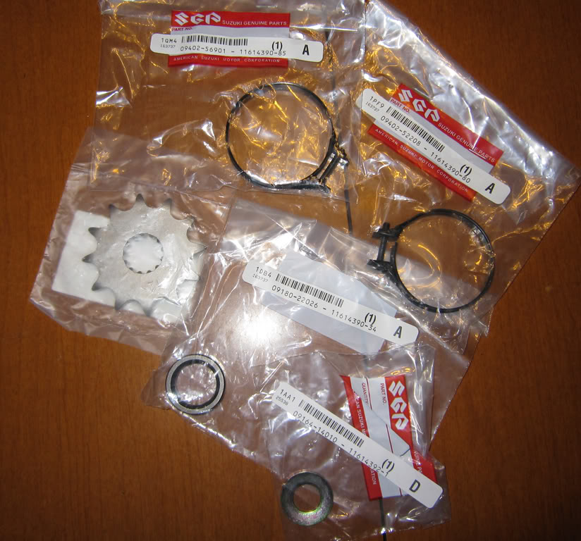

More parts, still no time. Intake boot clamps, front 12T sprocket (dropped a few teeth for some torque over speed) a final drive shaft outer spacer (should hold the oil back now behind the front sprocket) and an OEM balancer lock washer update (the first generation did not use one and the balancer would come loose)

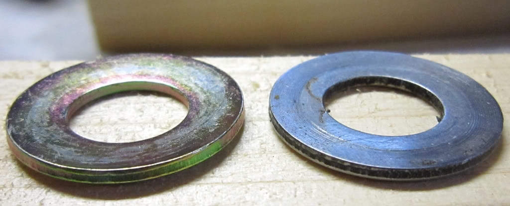

As you can see the new lock washer for the crank balancer drive gear has more spring to it, so hopefully it will not fall off again like in the beginning of this thread.

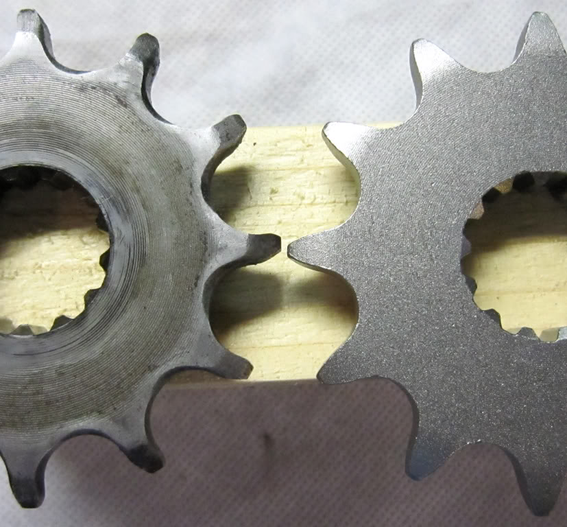

Comparing new to old sprockets, the old one was actually already a 12T so I am not gaining anymore torque (no wonder it spins the tires everywhere I go) also the old sprockets teeth are all bent in one direction.

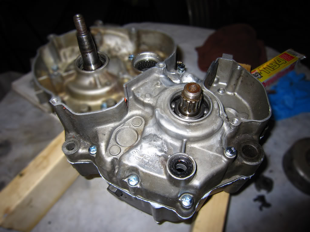

WELL...so long for the Winter project! It has sparked my interest again so I grabbed a buddie and some brews and started re-assembling today. I cleaned the inside thoroughly (the outside/flywheel compartments still need to be cleaned better before I continue reassembly) but I got the entire crankcase and transmission lubed and reassembled. All the seals but one have been pulled ready for the installation of the new ones, the Three-Bond that leaked out will need to be cleaned up with a razor tomorrow. The hardware store did not have all the bolts I needed in the same type, so I have three different head styles. I started with the slim allen heads, then phillips head machine screws like stock...then the hexagon bolts (you can see one sticking up I need to clean the thread tomorrow with a tap). The engine will deff need a good polishing after I am done, I gave the Three-Bond a few min to get tacky before joining the case half's but I do not remember reading to only go so tight for a few hours like Permatex usually says so I star pattern tighten it down:
