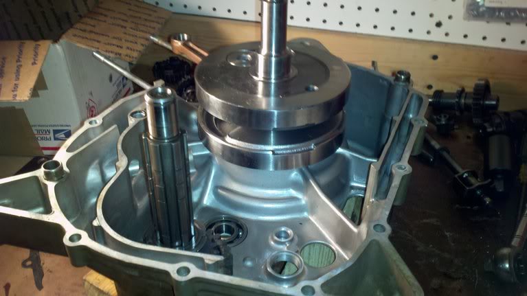

Got the crank back in the left case before work this morning. I used a heat gun to heat up the bearing and the area around the bearing until a drip of water dropped on it boiled off, then I dropped the crank in. No pressing, hammering etc, it just went right in.

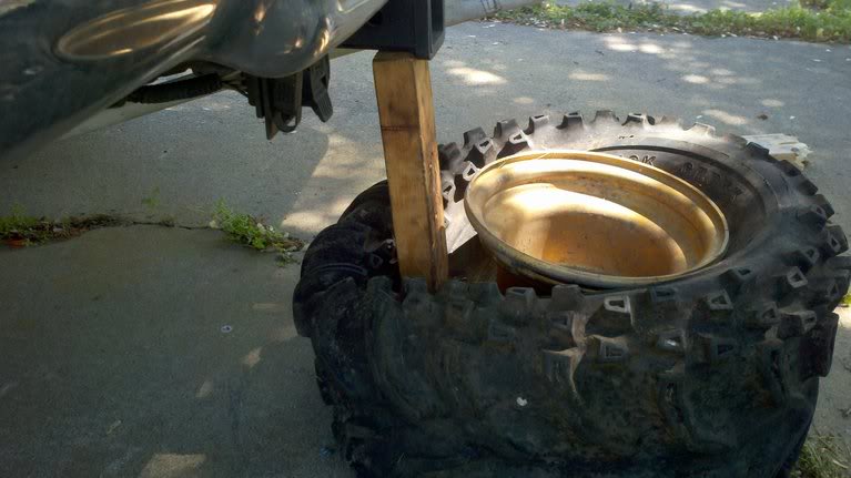

Still waiting on the thrust washer, machine shop and coater, but I know I need at least one rear tire so I decided to break the tire off the rim. My F150 hitched turned out to be a pretty good bead breaker. I jacked the truck up a little, threw the 2x4 in there and let it sit for about 15 minutes, the bead popped off on it's own while I was inside.

This tire had been on that rim since probably 1988 or so, I was a little surprised it worked. It had a gash on the sidewall so I could not keep any air in it at all. Normally when trying to break a bead I leave some air in the tire, that was not possible with this one.

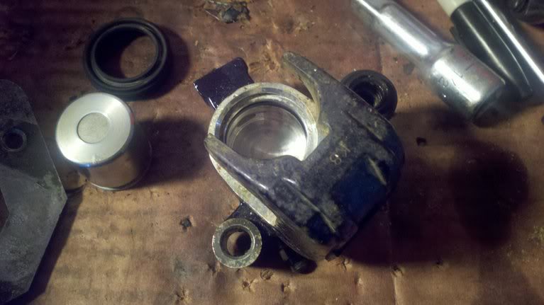

In the meantime I decided to pull one of the front calipers apart to see how it looked:
It looked pretty good. The seals were fine, but I am still going to replace them. There was a little residue on the wall, I used 0000 steel wool to remove it. The bleeder valves will need to be replaced and I am afraid I will need new brake hoses. Suzuki does not make them anymore so I will just have to find someone local to build them for me. I could go with stainless braided hoses . I need them for my bike anyone, might be cheaper to have them all made at the same time.
