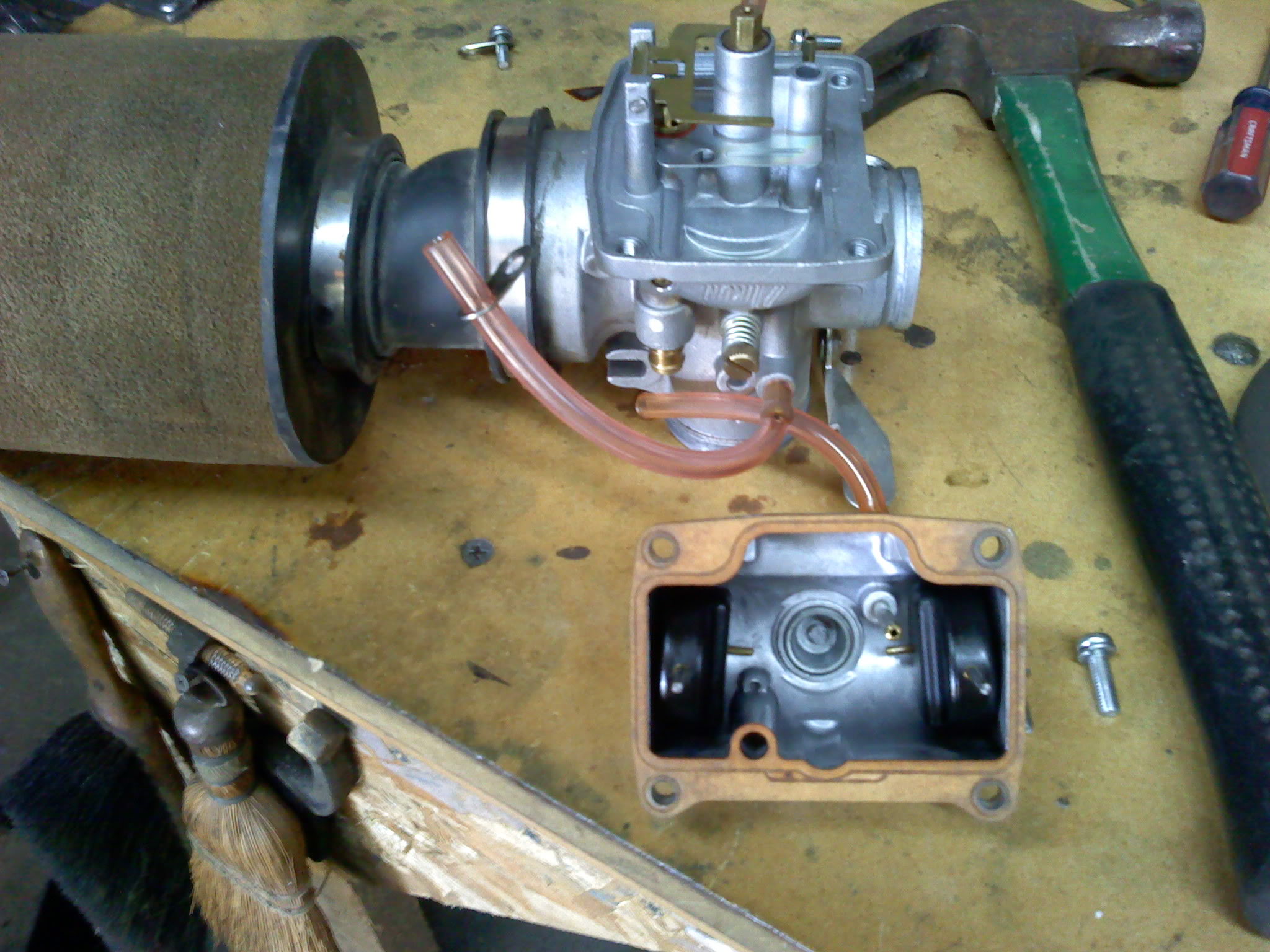

I ain't believing this.... I took a shell of a 32mm carb and threw in a O-6 or O-8 needle jet (can't read it for sure), a 250 main, a 25 pilot, a 2.0 slide, and 5L1 needle on 3rd clip and it ran darn near perfect first try! My lucky day... I should buy a lotto ticket lol. It runs perfect. No stumbles anywhere. All angles. I guess the big float cavity made a difference... along with a pretty restrictive small foam filter. I think these carbs need that restriction behind them to work right. I'll post pics later.

Here is the carb that worked.
