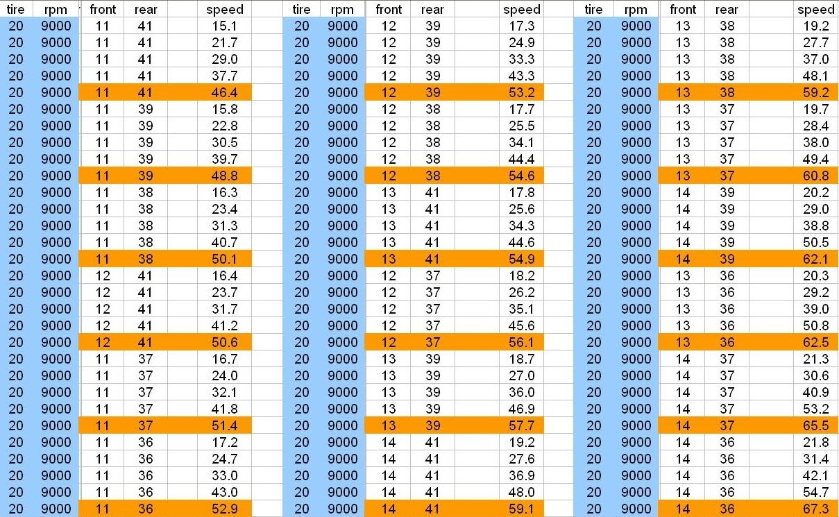

im looking for a sprocket and chain upgrade to get my 92 lt230E quadrunner some extra speed in its go! any idea please let me know it currently has the 11/41 stock setup.

whats a good ratio for speed like 13/39 or 14/43? all need to me

I think 12/41 is stock with 22 inch tires and 12/39 is stock with 20 inch tires. Both have the same speed.
13/39 is popular. A 12/36 would be better if you could find a 36. You don't have enough engine to run a 14.
These are in order from slowest to fastest:

idk if mine will even do 46 lol it seems slow

Where did you find that chart?
Old Mar 19, 2013 | 06:29 AM
JustRandy's Avatar
Joined: Mar 2007
Posts: 5,227
I made it

What would be a good sprocket combo for a LT250S with 18" ITP Quad Cross MX Pro tires?
I got the the tires new with ITP rims for dirt cheap so I thought I'd try them on the quad though they are a bit smaller than stock.
