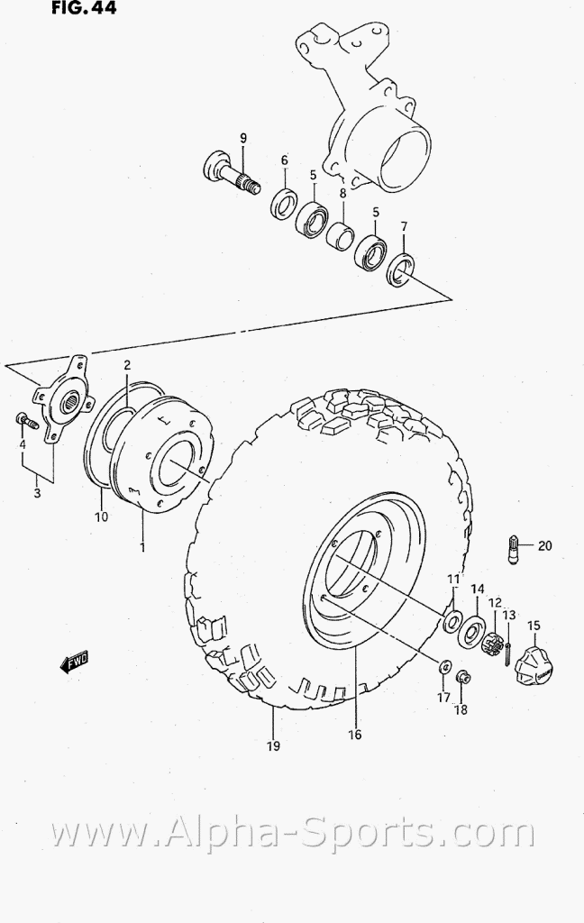

I have a 1990 quad runner 4WD. The left front wheel has stopped turning. I'm assuming wheel bearing? Is this something someone with moderate mechanic skills can change? Any other possibilities?

I suppose a wheel bearing could lock the wheel, but seems like it would make a lot of noise for days or weeks before it would lock solid like that. Usually what happens is the bearing gets really sloppy and you'd see one wheel leaning more than the other. I'm a bit more inclined to think the brakes locked somehow. Maybe the wheel cylinder locked. Maybe something fell apart inside and jammed the shoes. Of course, strange things happen and it very well could be the bearing. You'll have to take it apart and inspect.
I think you could handle the job if you're not totally new to turning wrenches Take a pic of the shoes and springs with your phone so you can figure out how to reassemble everything. Make sure you know where every spring goes. There is a ratcheting mechanism that can be kinda tricky to put back on near the wheel cylinder. Pay attention to that before you take it apart.
