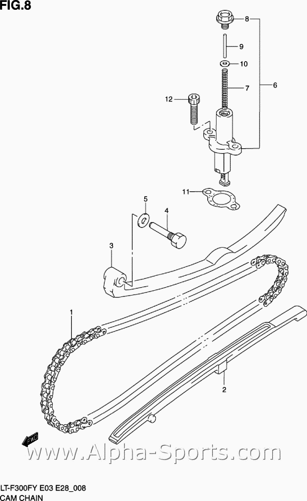

I still can't see the cam chain stretching. It has twice as many plates as a 250S cam, yet the cam is less aggressive. If you can measure it, the book says the 20-pitch length should be 129mm (5.08 in).
Another thing I've seen happen a few times is the cam tensioner slips. The teeth get chipped or rounded and the ratchet slips.
Another possibility is you didn't put the chain guides in right.

I can take the tensioner out completely and still the chain is so tight I almost can't get the cam out.
How did you jack up the compression? If you milled the jug or removed gaskets, then that is why your chain is so loose. What I do in that case is weld a nut on the end of the tensioner to give it more reach.
I'm not going to believe your chain is stretched until you buy a new one and post a pic of the two hanging side by side so I can see it lol

So with mine if i take the tensioner out i can just slide the cam and gear straight out. Ill i did to raise the compression was new rings and lapping the valves. I put all gasekets back like factory with no milling. Im planning on just replacing the valves this summer and having the seats recut and probably just putting a new chain in. Have you ever had issues with welding that nut on.

I've never had an issue with welding the nuts on. I've done it more times than I can count on lots of brands of atvs. Another thing you can do is leave out the gasket on the tensioner. And you could add another base basket under the jug.
Be careful ordering the chain. Rockymtnatv sent me the 250S chain and then said they don't have the king chain. They let me keep the wrong chain though. It's a bit hard to find the right chain.
