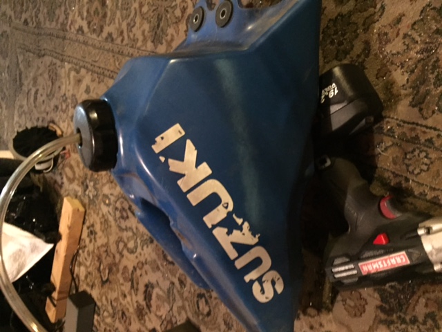

Here are some pics...I sent you a PM on the price...
