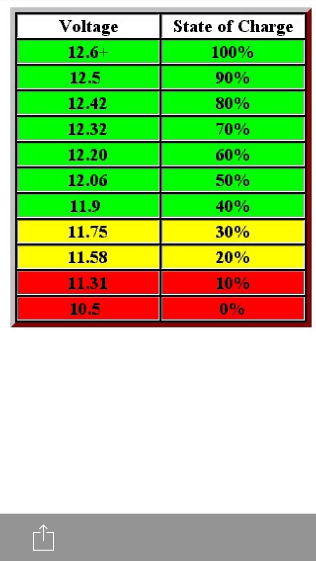

As far as the wobbling, grab each tire at the top and see if you can move it in and out. If it's loose, I'd suspect wheel bearings. If you replace wheel bearings, try not to use Chinese ones. Japanese or maybe Timken made in USA ones. Use a press to remove and reinstall, not a hammer. I run Koyo's in my Arctic Cats. First check battery voltage. Here is a chart. More is better when it comes to ATV's. Siezed lug nuts have to get fixed, new studs, new lug nuts, or you'll be left in a bind when a tire goes bad.
So to check bearings I have to jack ATV up and push the tire in and pull out if it moves replace the bearings ?
ATV battery is fully charged according to your chart when I push start button theres no clicking or anything but if I jump silinoid with a screw driver it starts right away or I can hook booster pack up to battery and start it that way ...

Use an impact gun on the lug nuts after soaking them over night in penetrating oil, if the snap off then so what you need to replace the studs anyway. As far as wobble follow the instructions given in previous posts and also check to see if you have a bent rim or really way off alignment!! As far as the electrical issues, you need a multimeter to check things out and also do a battery load test. A battery can show good voltage but when a load is put on it it dies. Also check and clean (polish)all electrical connections and check for good ground. All these things are basic and need to be covered before any more in depth information can be given.
