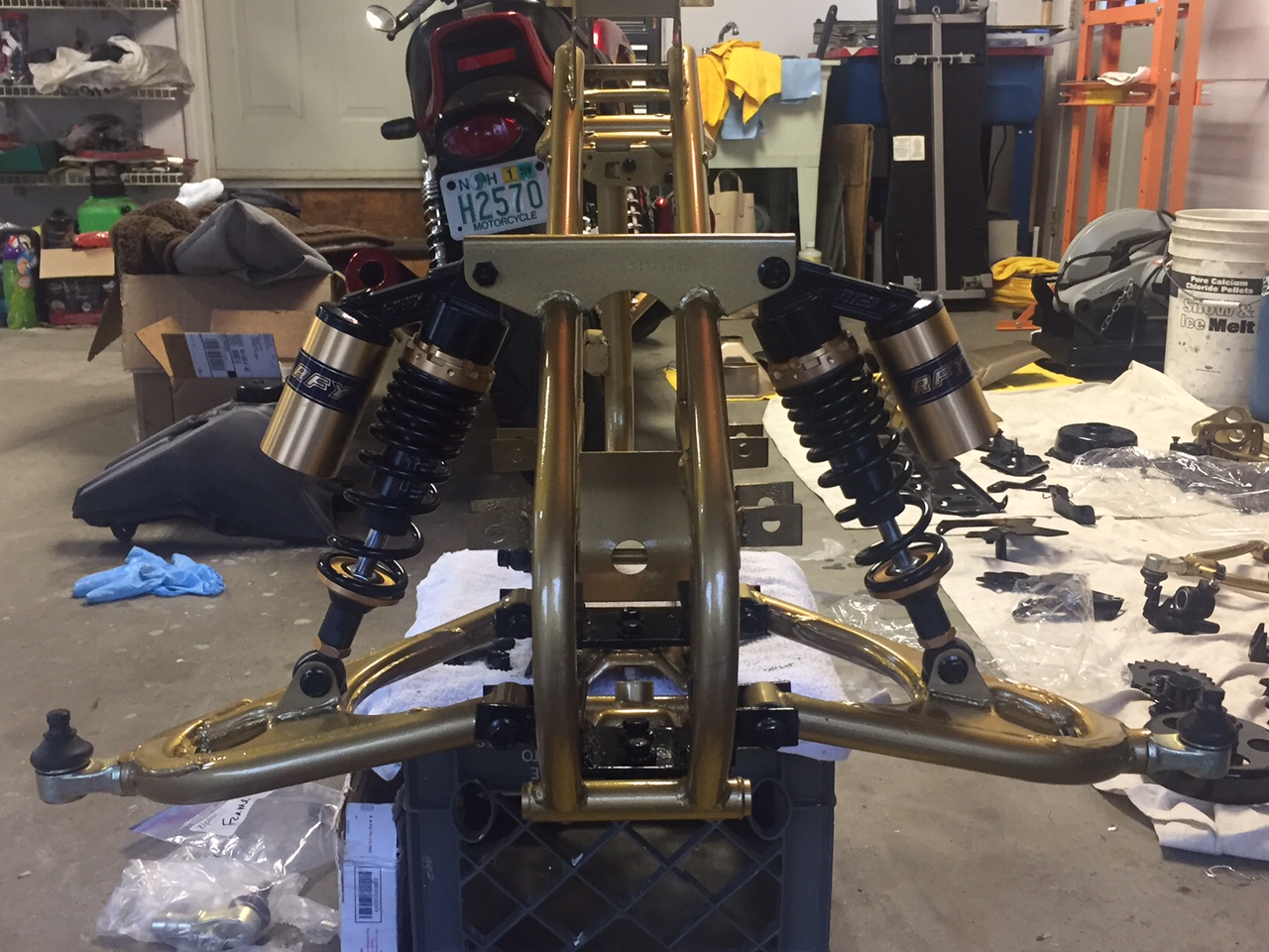

The mod is to cut the single footrest support in half (stand the quad on its *** end and you'll clearly see the footrest pipe going under the engine, carefully cut this with a 4" cutting disk, this will allow you to remove the clutch side footrest without motor removal...you'll need to weld in or otherwise insert a smaller OD pipe to allow the 2 halves to be reconnected).
If I remember, I'll take a pick of mine as they are off the machine...

Hey...there is now SOMETHING on the quad!!!!

Looking good.
