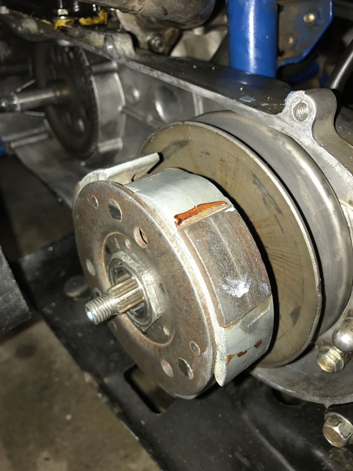

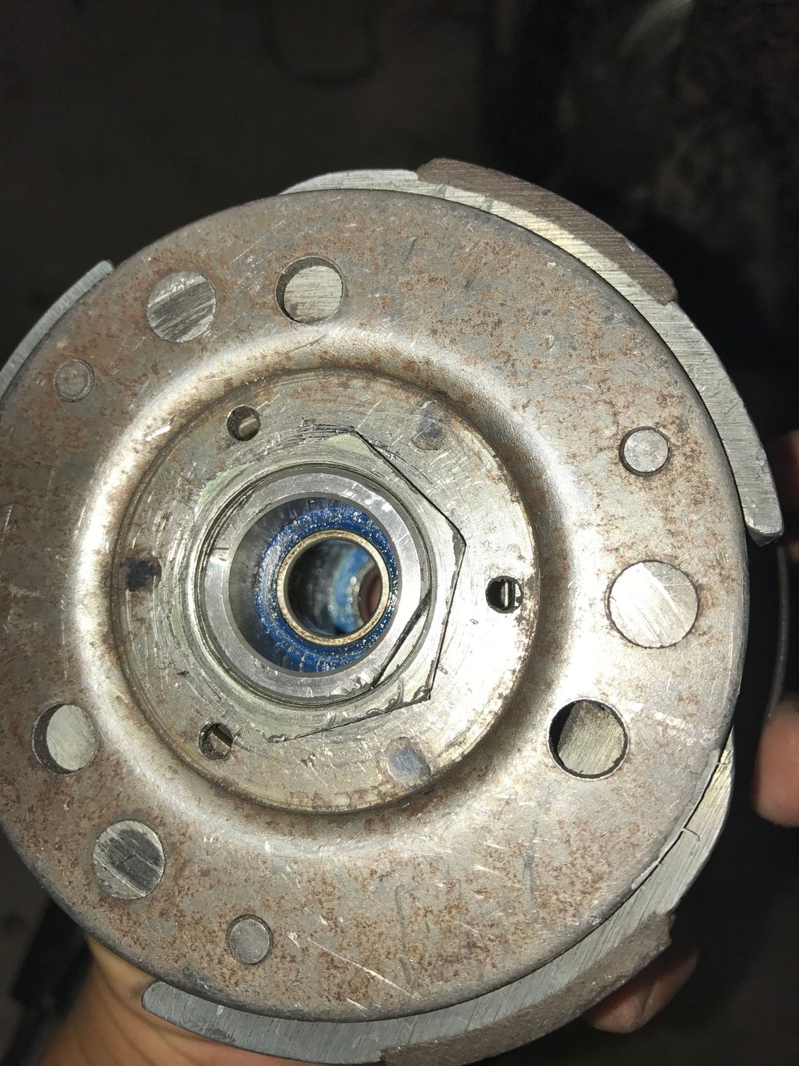

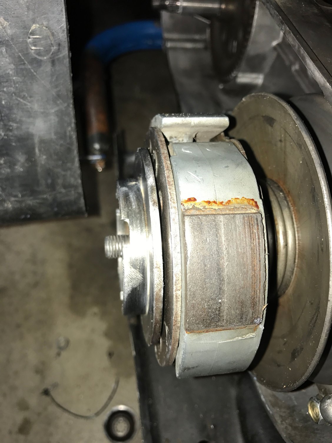

Here is the assembly.
Small bearing is pressure fitted and has the snap ring in place.
Bottom bearing and it is flush with bottom.
Small gap in between.
First friction plate
Drum
Second friction plate
Not sure if this is correct way to put this on looks right from other pictures I've seen.
Here is the umbrella piece. You can see the spines coming through.
Until I get the specialized nut I put a washer then a regular 10m nut to keep it off the spines.
Is this all correct?
