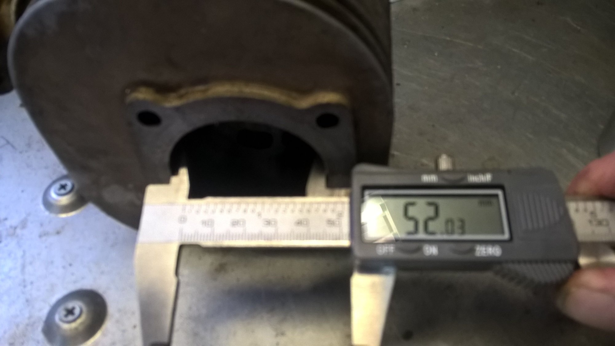

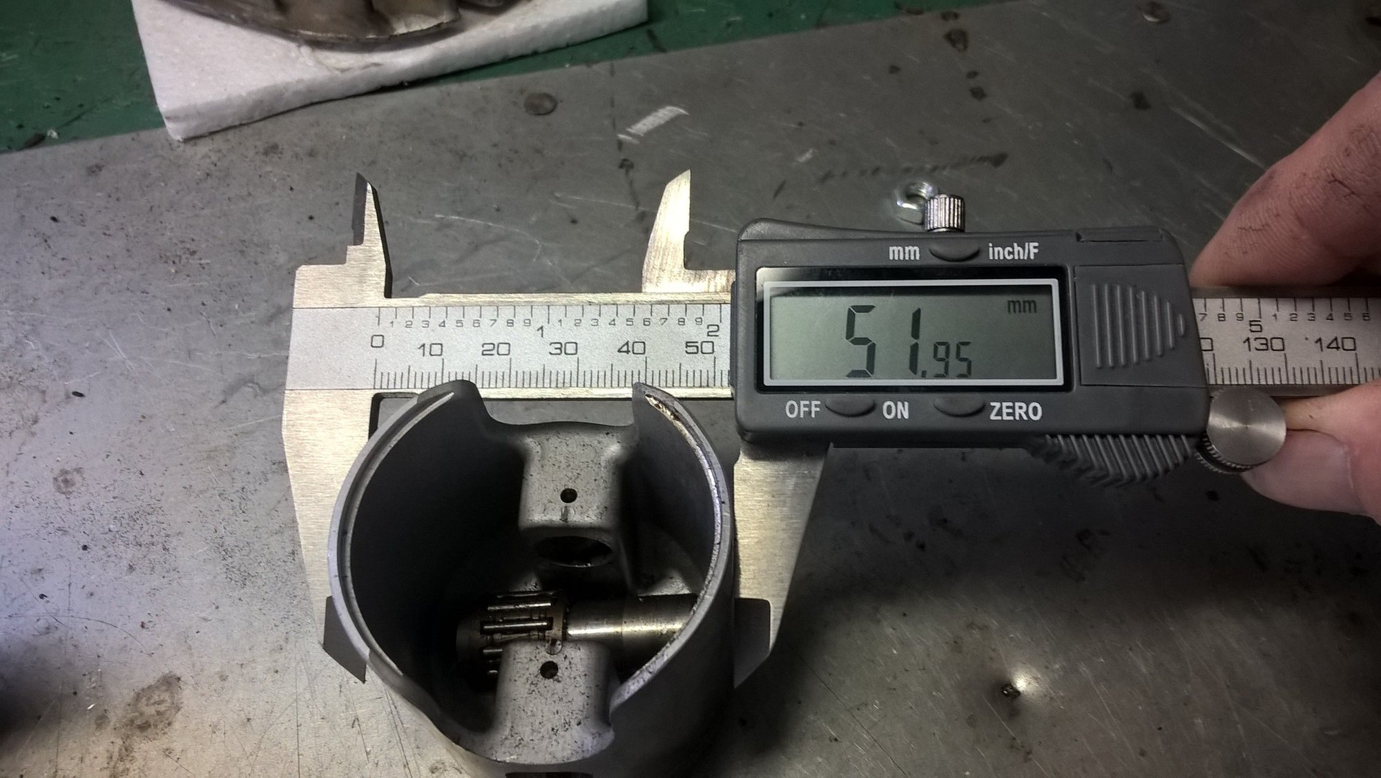

Default better measurements
Old Sep 9, 2018 | 05:28 PM
  #34
no_whereman's Avatar
Joined: Jun 2012
Posts: 69
From: Colorado
Not sure why pic overwrote my text.
Anyway, I was able to look up that number on top of the piston and it is wiseco 2 over.
Thx for the reply LT80,
I cleaned cylinder and took the measurements at top and bottom. I don't have means to measure middle area. I would be interested in what you have. Probably my best option.

You can measure with a inside but your measurements would indicate a pretty straight bore.
So anyways, your cylinder/piston has 7-8 thousandths of clearance which puts it in the wore out stage. A new piston and rings may snug it up a lil. I'd guess it'd bring it down to 5-6 thousandths. Clearly a waste of money.
Anyways, I'll respond to the PM and you can get a good life out of a Suzuki cylinder and piston.
