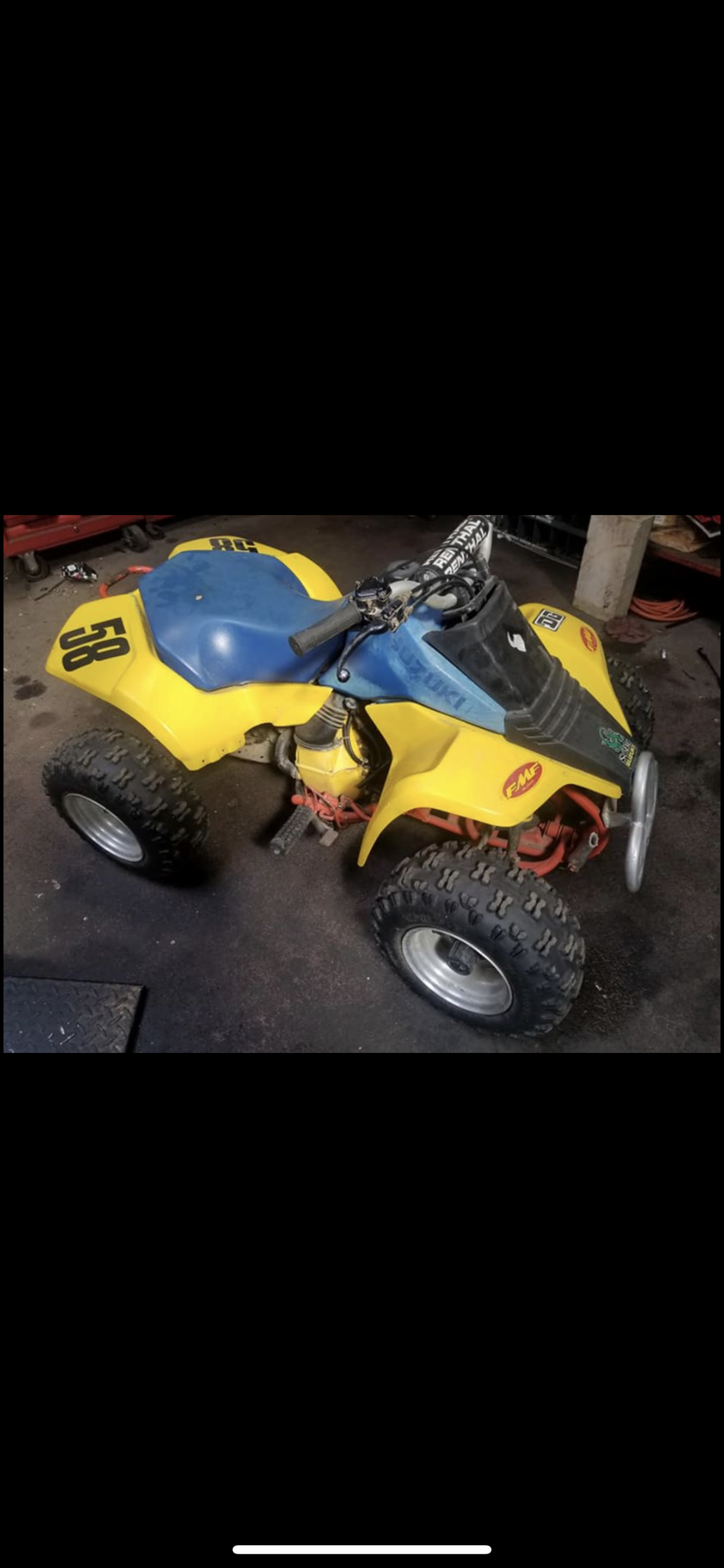

Was going to get the hard starting LT80 but found another one that starts with no issues and I like that it’s got holeshots and wheel spacers for a wider stance. The FMF exhaust doesn’t hurt either. All for a pretty fair price too. Any ideas on the year? The owner doesn’t know.
