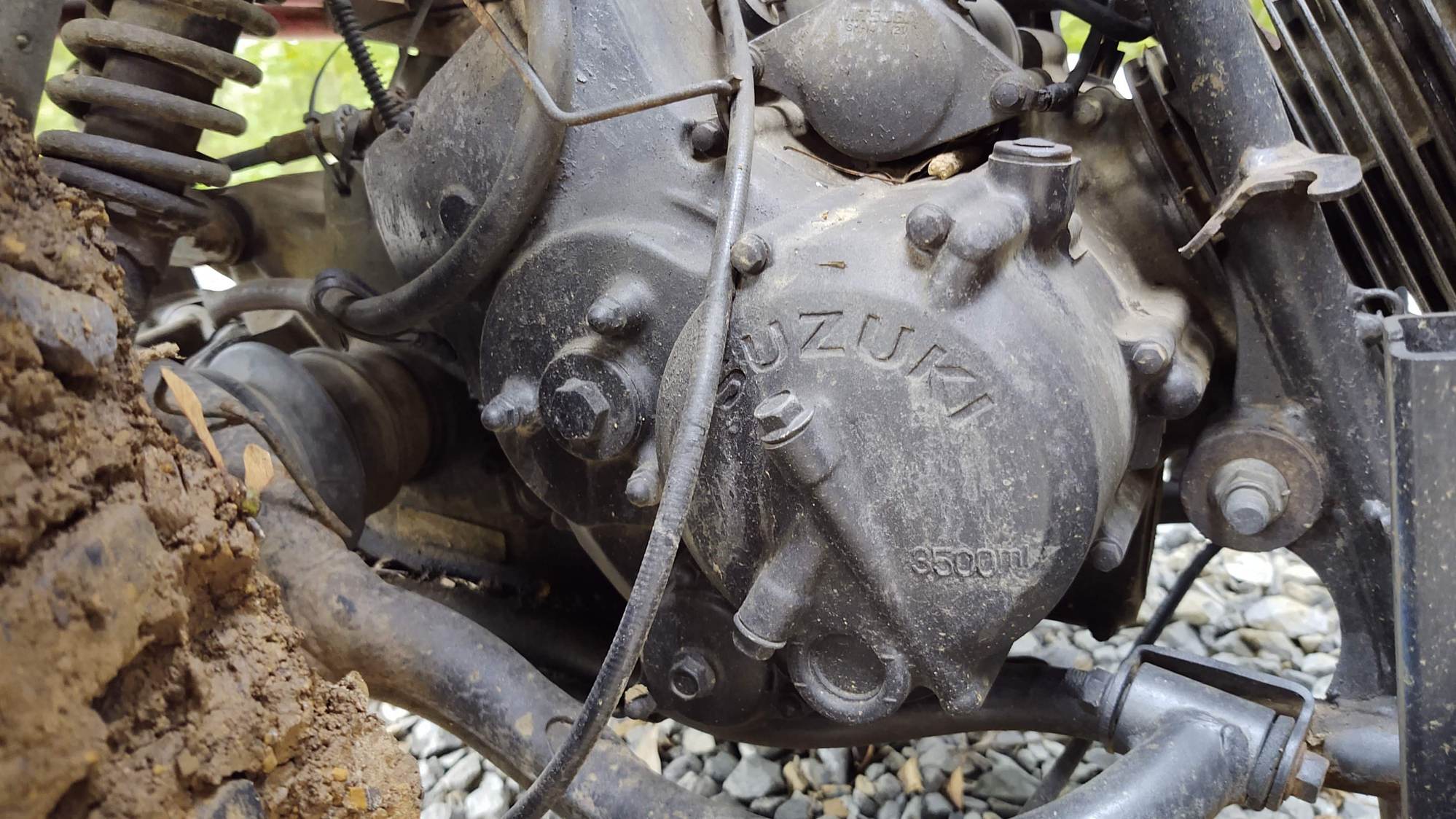

Hi, I recently acquired a ridiculous contraption, it's a Yerf Dog Rover UTV...with a Suzuki 250 powertrain attached! It's got a hand shifter, and it's hard welded to the frame of the utv. It's pretty fast, when it runs. Much faster than most little utility trucks. I really need to re-ring it (smokescreen) and rebuild the carb (doesn't idle). But I don't know the model of the engine and I'm having trouble finding a model identification tag. Can anyone help?

The most important question is do the driveshafts to the wheels come out of the engine/gearbox unit or does it have a little short propshaft from back of engine going into a diff? My guess would be that is a single unit, which would indicate a 1990s LTF250 rather than the Ozark engine, which does have a separate diff.
