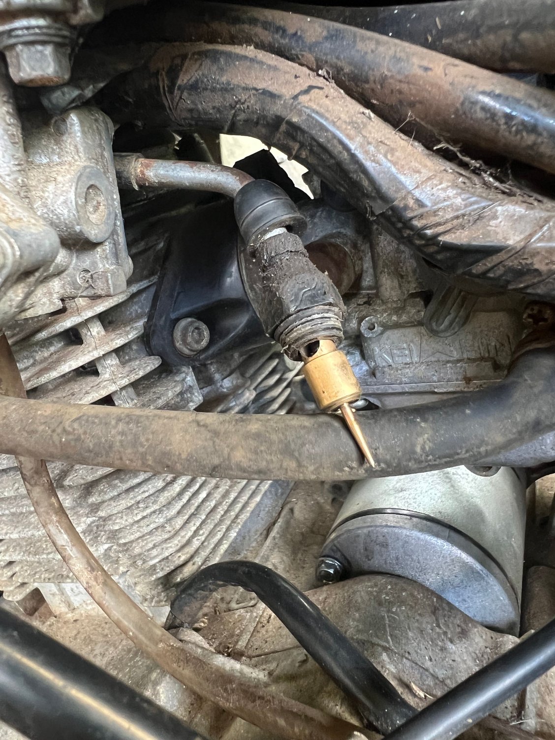

About weeks before, this quad was running awesome! Before the backfire, my uncle Wolf came over to fix the lever down by the gear box, we changed the spark plug, oil change with a new filter, new starter, battery has been always strong and just today I just swapped out to a new starter module. I did find this little golden pin that looked like when the carb backed fired, it maybe broke it. I will attach a photo.
Came out of the carb. what is this?
Also, how do I fix something that is jammed between a stator and a fly wheel?
What is a stator anyway?

As I wrote before "an engine that "won't turn over" is seized" but will it really not turn over? That brass plunger is the choke and must have been loose. The plastic threads that screw the assembly into the carb seem OK, if they are, screw it back in the side of the carb and see if the engine will turn over on the pull start, if it won't on the electric.
