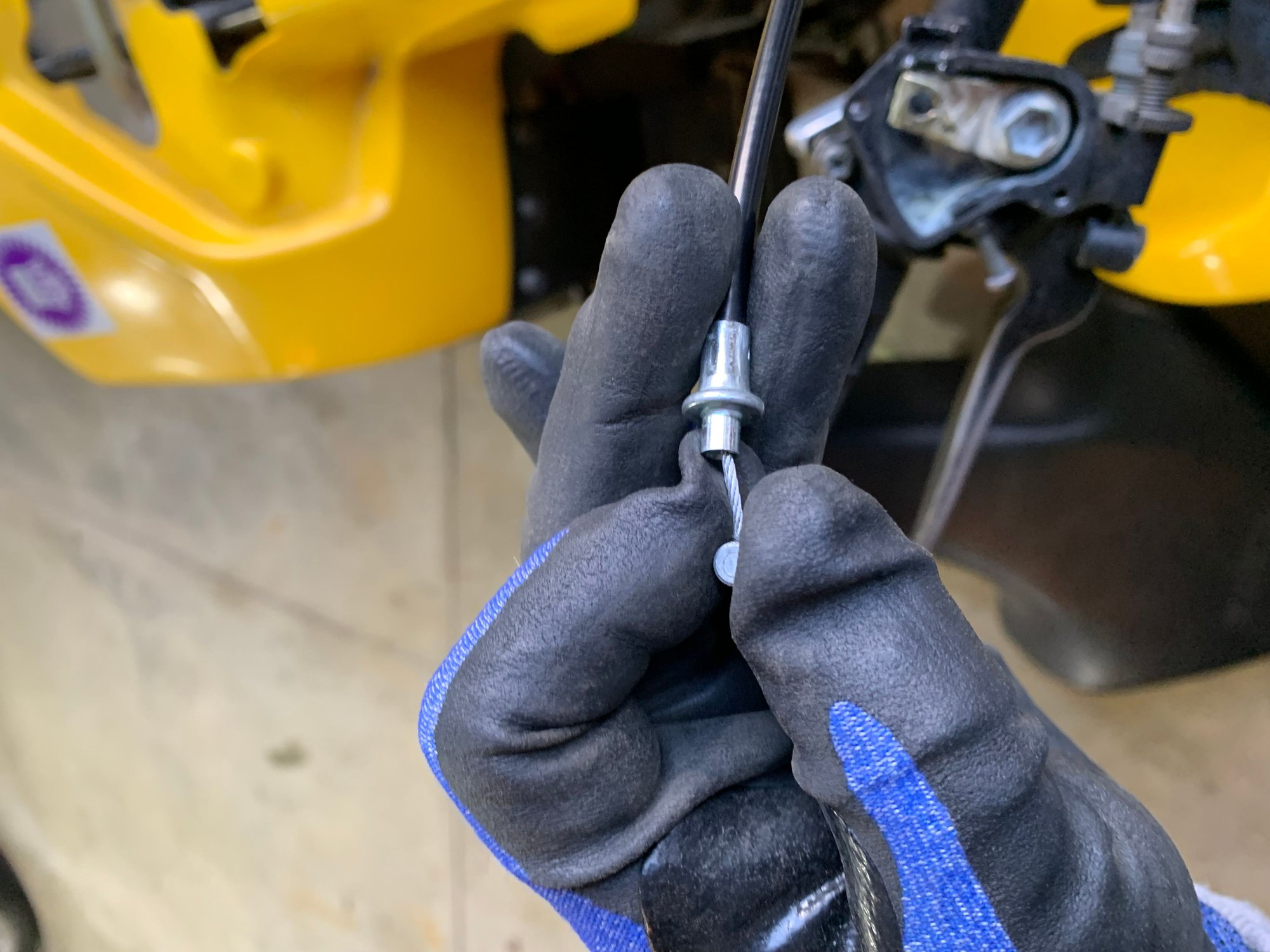

Funny you checked in (thank you by the way) because I hadn’t been able to mess with it until yesterday. So I tried “Take the cable out of throttle assembly and pull throttle cable with hand a see how it runs just to make sure that the only issue”. It started up and took off like a runaway diesel again. I messed with pulling the cable back and forth and you could hear the engine response but still so little amount of cable to pull. I’ll attached a photo of how much cable I can pull. I had to shut it off as quick as possible because it was spraying fuel out the area circled in the other photo and out the exhaust.
Where I am now… There’s no way the cable is long enough to be letting the needle seat down into the carb all the way. I’m basically starting it in full throttle every time. I think this is the reason for it taking off like it does right away. I’ve ordered a new throttle cable that is OEM and when it arrives I’m gonna see if the one I bought was wrong.
As for the fuel now dumping/ spraying out of both ends, I don’t know what’s causing this. Separate issue? A clue to something else? I won’t have any idea until I fix the carb/ cable issue and get this thing to stop shooting out of a cannon.
If this cable comes in and it’s no different then I give up and will have to take it to a shop.
All the further cable movement I have with the carb end put back together

Well here’s where I’m at… throttle cable that I had ordered before (China version) was too short. The OEM part I just got from Partzilla fit perfect and allows the throttle to have full motion. I’m confident the jet needle is seating and doing what it should now. Lesson learned there.
