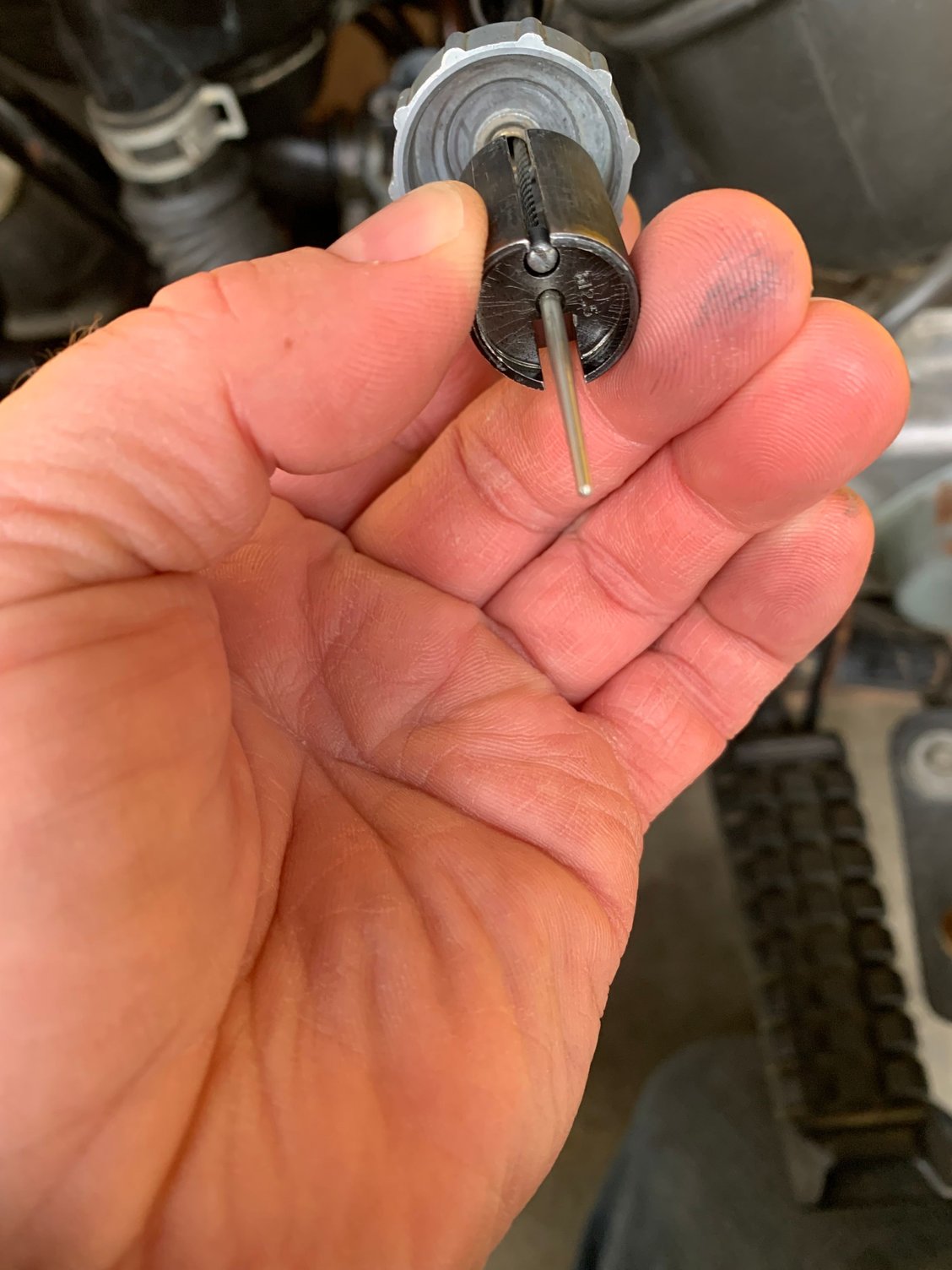

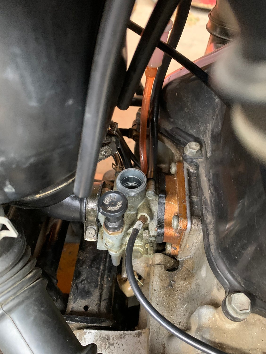

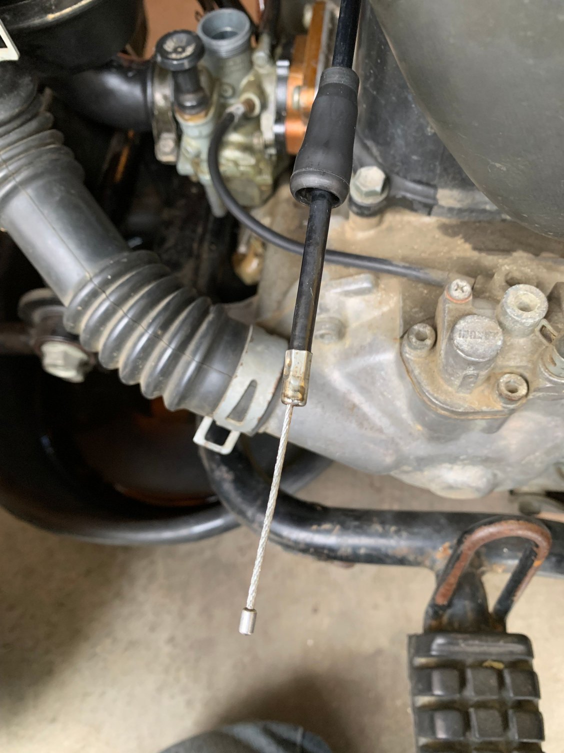

There’s no spring in these photos just to make it easier to see the slide. So here’s where I’m at… when it’s all assembled the thumb throttle only moves a 1/2” max. Is it possible that I need to lengthen the amount of bare cable that’s able to go down into the slide? Assuming they make new cable crimps to do this.

I guess the makers could have got cable length wrong, check against the old cable. Also be sure the crimps are not too big for their seats. I have come across some that don't sit right down in the adjuster, usually on new Chinese carbs coming with wrongly made adjusters. However best to check if the slide is actually sitting on the slow running screw in the carb and there is a bit of slack in the cable before thumb throttle starts to pull at it and lift the slide.

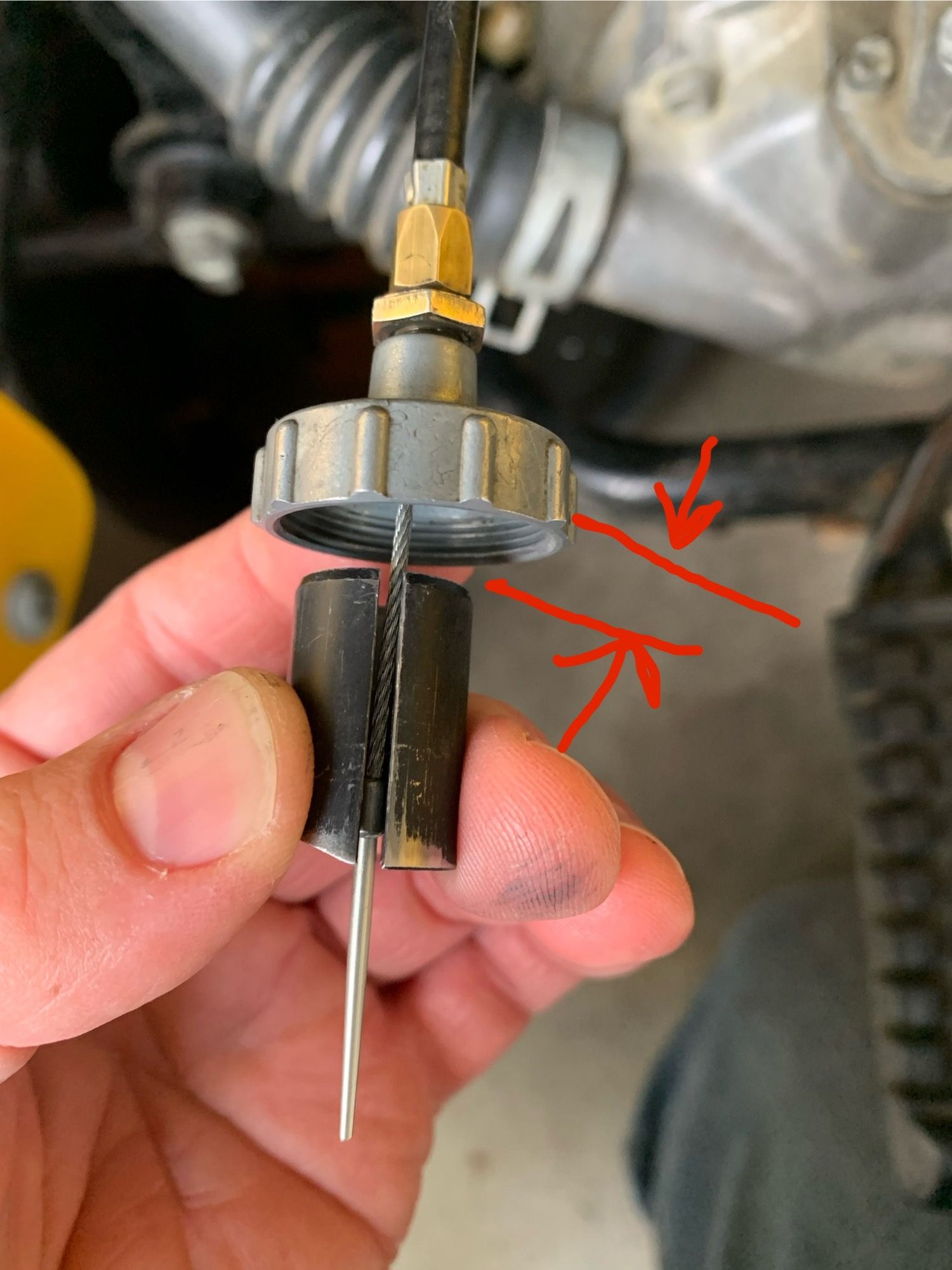

Will slide go all the way down without cable installed it? I notice in photo the brass jam nut isnt down so I would turn the brass cable adjuster down all the way also may sure throttle limiter stop isnt adjusted to limit throttle from full movement and yeah will need to have that spring installed to help with throttle return

This space here is all that the thumb throttle will move. The adjuster screw at the thumb throttle is backed all the way out so unfortunately that’s not the problem. If I just drop the slide down in the carb it goes all the way down inside and bottoms out. I thought the throttle cable was the exact same length as the old one… before I threw the old one away 🙄. I can’t think what else it could be.

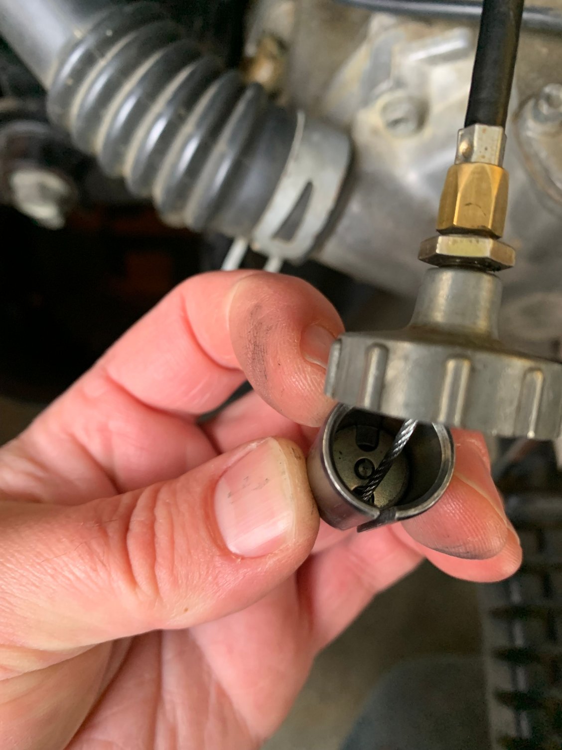

Turn brass nut all the wat to the brass cable guide in this photo and then turn the brass cable guide shown in this photo all the way down to the slide cap nut that may give you more movement

I tried this but the slide and needle are still far from sitting all the way down into the carb. When I start it up, it just goes into full throttle. I’m tempted to buy an OEM throttle cable and compare to this one I have.
