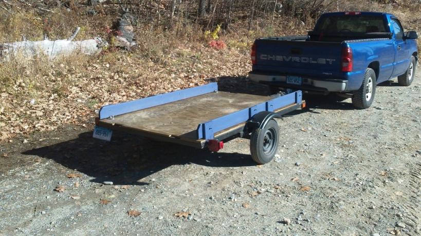

I have to run mine at about 1/2 of the max pressure. Any higher and it eats the center of the tread right off.

With that little flatbed, though, if it did bounce badly or wear too much down the center I might consider backing down a bit.
