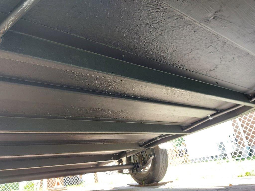

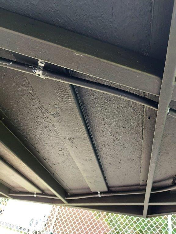

Since my above post, I finally finished DIY undercoating of my enclosed trailer.
re: 2 x coats on the main body and 3 coats behind each wheel (where more road crud is sprayed upwards).
For product and after results (using a 2" paint brush to push into cracks), see attachments.
Hope this helps others.
This product was bought at Home Hardware.CA store. Might be available from other sellers.

If wondering, I bought 5 L jug and only used 4 L of it. I used a 2" paint brush to push the tar like liquid into the cracks as well.
Tips:
- Wear old "throw away" clothes and plastic bag shower cap -> from Dollar Store
- Wear "throw away" long sleeve shirt or spring time coat as well.
- Use drop sheets and wear clear eye glasses -> side protected clear safety glasses work best..
- I applied one area at a time. re: The rear area one day and its front area next day.
- I applied two coats + 3rd coat behind the wheels area
- Before slipping on rubber gloves, wipe hands with dish soap as well.
Note: No need to visit local gym for exercise. Simply do this exercise (for stomach crunches) instead. Smiles.
This worked for me... Hope it helps you as well...
