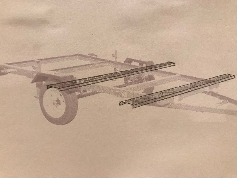

Here's what I had in mind:
The idea is to mount the loading ramps to the trailer so they are fixed. I could use another set of ramps to load it. Once loaded, the weight of the quad would rest mostly on the ramps just above the trailer frame. There would be no weight on the middle of the ramps, so there should be very little risk of the ramps bending or failing. I would also do a similar setup on the rear half for a smaller quad. Thoughts?

Here is my idea:
The ramps would be attached to the trailer. I could use another set of ramps to load the quad up onto the attached ramps. Most of the weight of the quad would be on the trailer frame since the wheelbase is basically be the same width as the trailer. There would be no weight in the center of the ramps, so no real risk of them bending or failing. Everything would be tied down tight. I would also do a similar setup on the rear half of the trailer for a smaller sized quad. That would allow me to tow two quads on one small trailer. I would be well under the weight limit of the trailer. Thoughts?

The folding trailers I've seen all looked like junk. I was reading what this guy did to his to make it actually work but got bored before I finished. It may have been cheaper for him to buy a regular trailer and store it somewhere else. A friend might settle for a 6-pack as payment when you come to get it. After all that time and money he still only had a 4'x8' trailer. My ATV is 4' wide and would have to be dead center. I just looked online and Harbor Freight doesn't even have those trailers listed anymore. Maybe someone else actually makes a good folding trailer.
