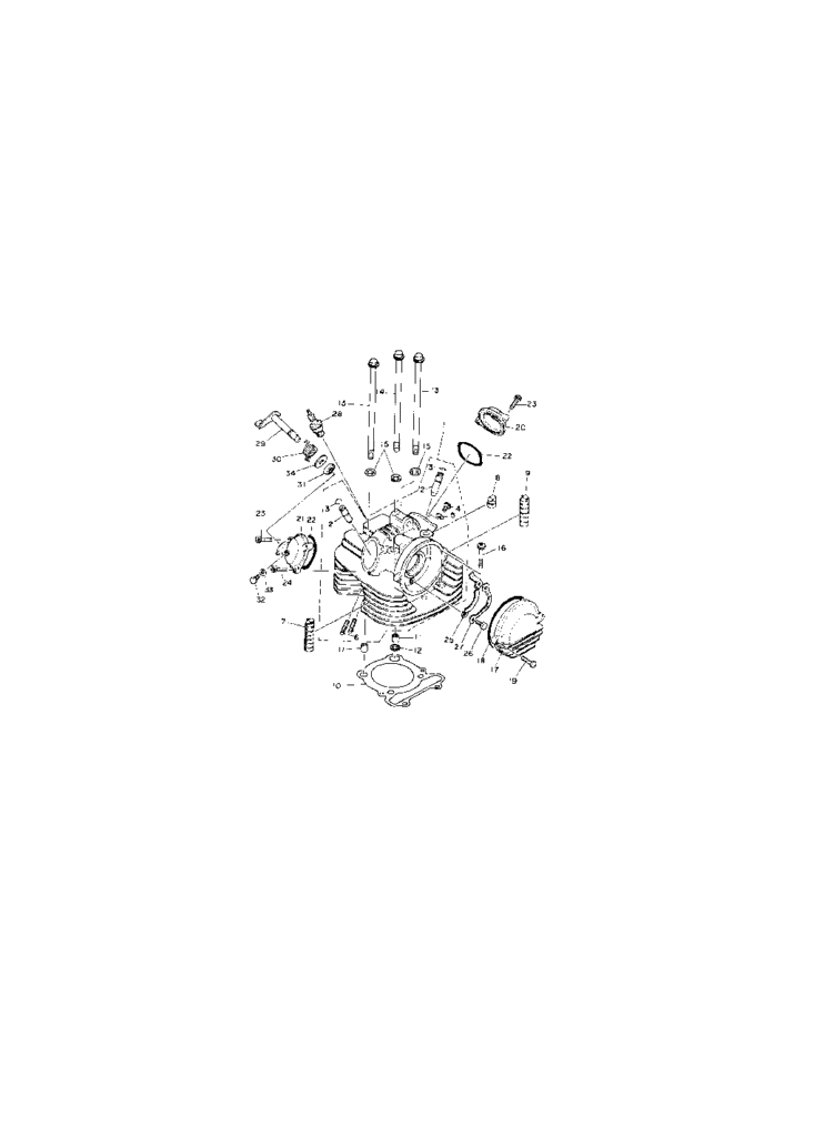

yea i forgot he mentioned the decompress release, that must be an older pullstart 87-89ish model, i guess it would be a good idea to check out that make sure it isnt something simple, its worth a try, heres a little pic to help u out with what parts there are on it...29 is the little lever and u can see what all else there is...kinda small pic lol.

Awesome! I'll check it out. Thanks for ALL your help!
