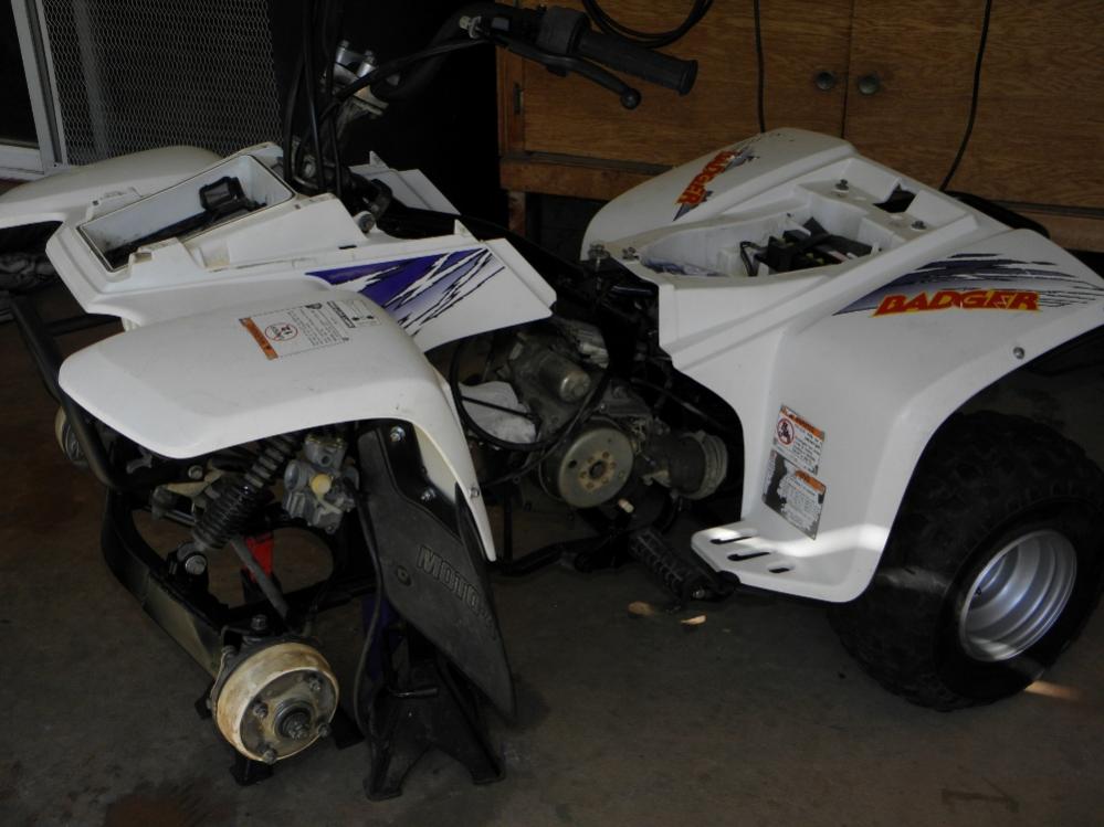

Here are some pics of my progress. Just by chance, does someone have a late badger they are parting out. I need that front suspension piece that was bent by the previous owner. I hammered it as best I could but it still seems to a little bit off. I actually used my sledgehammer and not the hammer seen

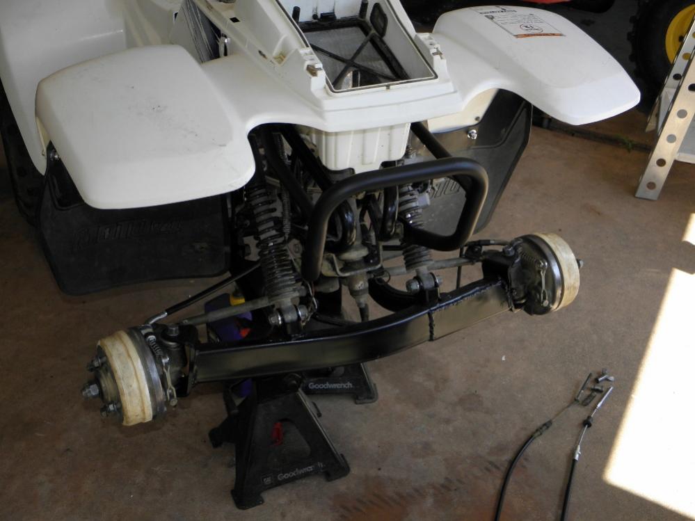

I finally found some time to work on the Badger again. I was able to heat up and bend out most of the twist on the front frame part. I then welded a piece of metal to give it strength.

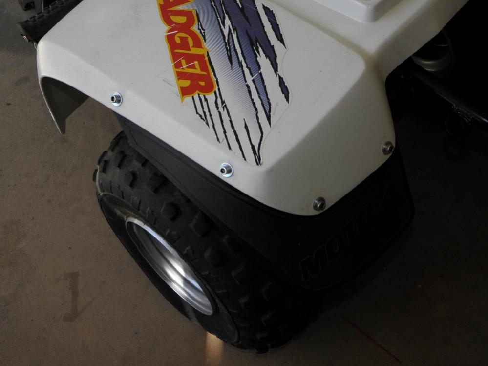

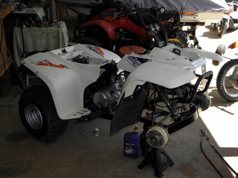

I reassembled and painted more parts. It is starting to look like a quad again

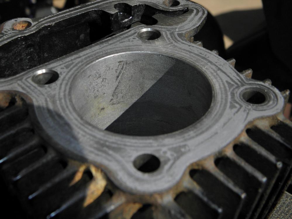

I was also able to unassemble the top end to see what my low compression was. Both rings were stuck, I pulled the piston off and have it soaking in PB-Blaster for now. The measurement of the jug is 47mm, so it's stock and never been bored. I am going to drop it off at the machine shop to get it honed to verify it's ok to just get some 47mm rings.

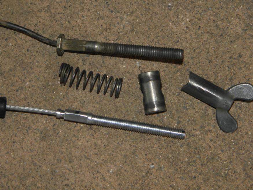

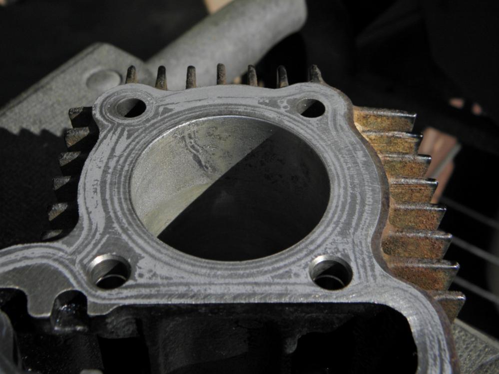

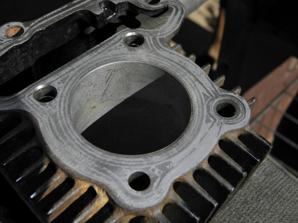

Some pics and some of the damaged jug. I tried to just hone it but that just brought out how really bad it is. Gotta bore it now.

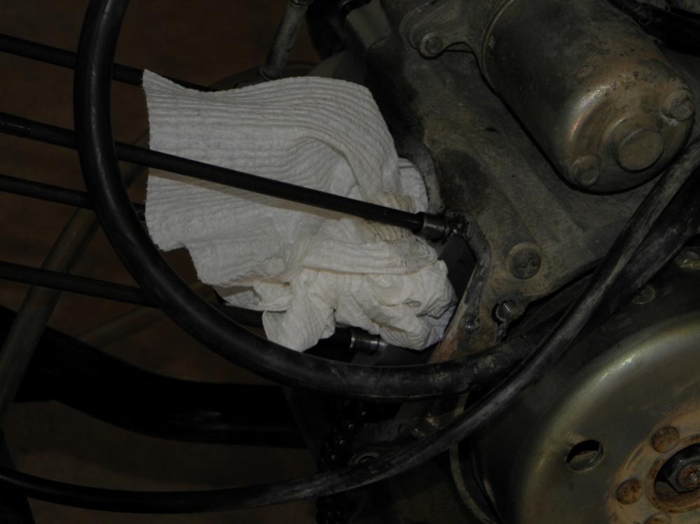

more pics
