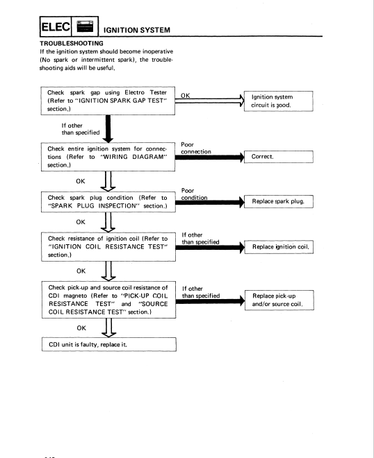

Default Its fixed
The issue with having to prime the plug with carb cleaner was resolved, I replaced every ignition part on mine or so I thought until I actually found a service manual. Turns out it after spending 400$ on CDI, COIL, and Pulser it was actually what is called a source/charging coil. which is located behind the magneto. you will need a special puller to remove the magneto. The coil and new seal was 61$. you will need to solder it back on and be sure to cut the wires very close to the old one! Ive included the service manual on testing the ignition system and the part number/name below.
3GB-15451-00-00 GASKET,CRCS COVER (Yamaha) $15.02 Available Thursday, October 29, 2020 5G3-85520-M1-00 COIL,CHARGE (Yamaha) $33.22 In Stock
