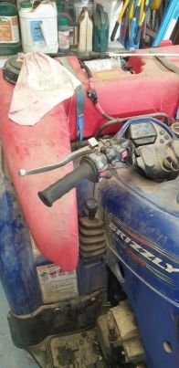

I've taken a good look at the shifter and it's not really obvious how I get to the mechanism under the gear lever shroud and I don't want to damage anything by taken the wrong approach. Do I have to remove some of the surrounding plastic or does the shroud simply pull up to reveal the mechanism?
I use the Grizzly mainly as a spray bike and, in my case, I have a spray tanks front and rear (see pic). Will I need to remove the front tank?
TIA, Peter

I think the front fender plastic might be in the way of getting to the cable where it screws into the shifter assembly. Hard to say, as the only time I've ever really mess with it is when I already had the plastics off for another reason, and I was pulling the shifter assembly off to make more room.
It might be possible to get to to it after just removing the plastic over the tank, but I'm not 100% positive.

I have the spray tank off and inspected the top plastic work. It just appears as though the front fender may be a single piece of plastic rather than a left/right fitting - correct?
It looks as though the fender is lifted off in an upwards direction but the shifter mechanism is in a cup like depression in the fender itself which would stop the fender from being removed. Obviously the fender can be removed so, what's the trick to removing it?
Cheers, Peter

To pull the cover off the gas tank: 1) remove the seat. 2) remove the two allen head bolts on the sides just below the seat, and the two allen head bolts facing straight up just to the sides of the speedometer and indicator lights. 3) remove the gas cap. 4) left the plastic up from the rear sides; wiggling it around a little while lifting up should release it. 5) place the gas cap back on the tank to keep anything from falling in or having to deal with the fumes.
At this point, assess the shifter area and see if you can get to the threaded in cable. If you can't, you might have to move onto removing the front fender (and yes it is one solid piece for left and right that wraps all the way around the front).
To remove the front fender: 1) remove the front rack; there are two bolts coming up from the bottom in the wheel arch area, two going down attaching it to the front bumper, and two more facing down further back by the handlebar area. 2) remove the 3 nuts/bolts on either side that hold the fender to the foot wells. 3) remove the remaining 2 bolts holding the front of the fender assembly to the front bumper; they come from behind the fender just below the grill area and into the front bumper. 4) working the sides loose first (starting on the side with the shifter), work the fender loose while lifting it up. It can be a little tedious and tricky to remove with the front bumper still attached, but it's very doable.
Once all that is off, there's AMPLE room to get to the shifter. But hopefully just removing the gas tank cover will get you to where you need to get to.
I'm also basing this all on the work I've done with my Bruin 350, which is very close to being the same exact bike... But that being said, there may be slight difference...
