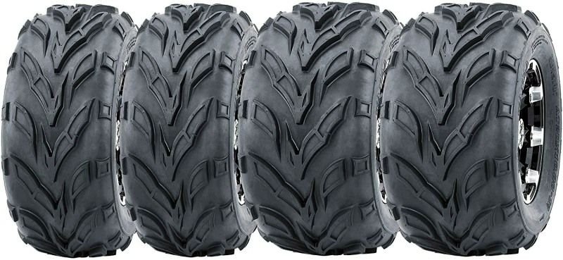

Will Duro 20 x 10-9 tires fit on my 2002 Bear Tracker 250, without any modifications to my machine? Also, rims I don't know what the bolt pattern of my ATV is, but the rims I'm looking at are 4 X 110. Thanks for any help!

Just one point not mentioned in the editors answer is offset, the standard wheels on the Bear Tracker have the flange near the inside of the rim, so any non standard replacements need this as well. If the flange is nearer the centre of the rim, the tyre is liable to hit the silencer when mounted.
