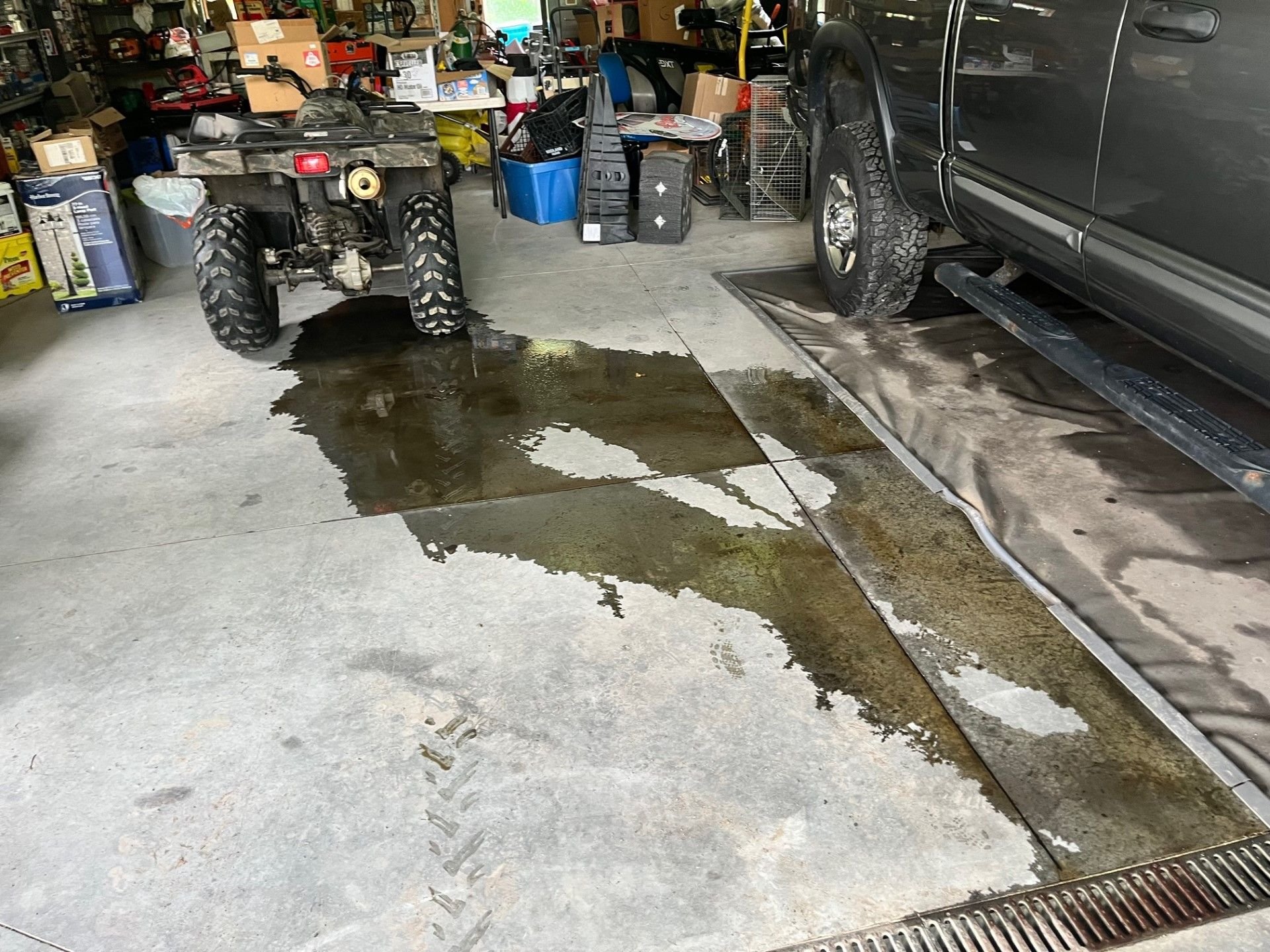

Angry HELP! My Kodiak puked everywhere

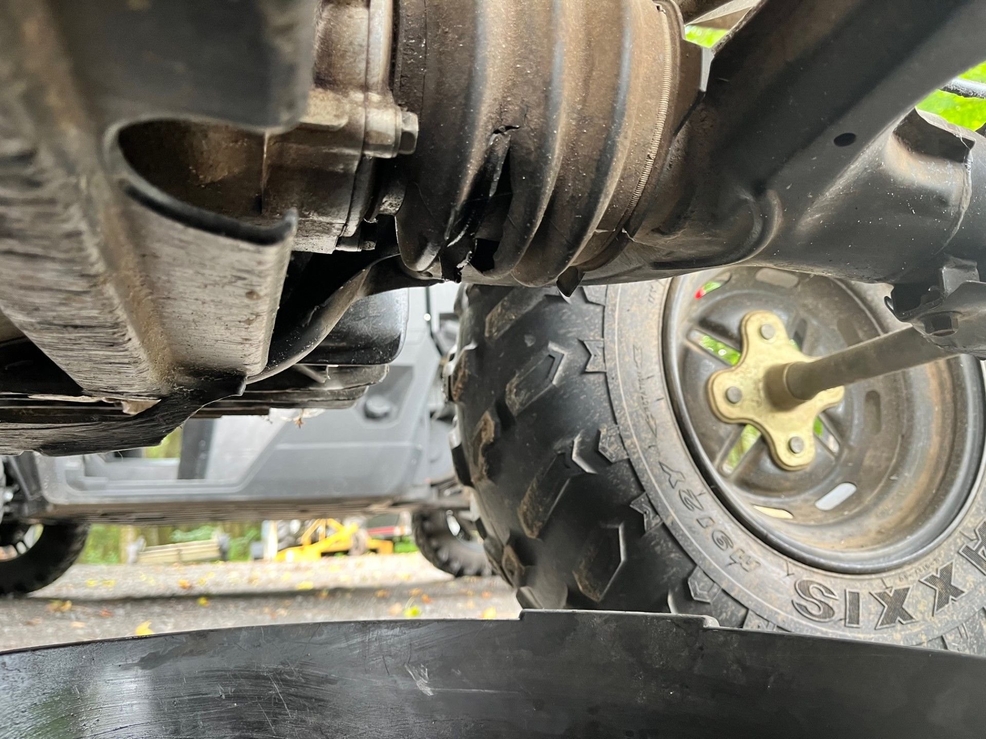

I bought this turd 03 Kodiak 450 not too long ago and have been meaning to start working on it, its been sitting outside under my lean to and I just pulled it in the other night to start wrenching on it. Came out the next morning to find it had puked oil everywhere! Any ideas what happened? I have a 2000 Kodiak 400 that has been flawless but this thing worries me, had the valves adjusted after I bought it as it was pretty noisy. Needs a bunch of parts. Im assuming I need to remove the entire swing arm to get to it? I bought a boot but no idea why or where the oil would come from back there?

Looks suspiciously thin oil and black, at a guess a mix of oil and fuel caused by someone leading the float chamber drain tube upwards instead of down. Then, when the float needle sticks, fuel runs into cylinder and airbox because it has nowhere else to go, and from there into the crankcase. Smell it and check the airbox. If it is fuel, drain sump and airbox, remove spark plug and turn engine slowly by hand to let any fuel out of cylinder, be careful, I have set bikes on fire when doing this, as a spark can ignite the expelled fuel. Dry air filter, clean carb out, checking float needle is OK, make sure that drain tube goes downwards, refill with fresh oil and try it.

As I wrote above, smell the stuff. From the pic it looks like oil fuel mix, but sump would be full if the fuel tank had emptied into it, unless it has a fairly major oil leak from a crankcase seal as well. Float needle has to stick for this to happen, but the drain tube from the lowest point of the carb, downwards, is supposed to pour the fuel onto the ground if this happens. If someone leads the tube upwards, when the needle sticks, the fuel can't run out of the tube, so runs out of throttle body into cylinder and airbox. Is the plug in the airbox bottom fitted? If missing, this would let the fuel out again. You check oil level with dipstick unscrewed on Jap stuff. Your other bike may, on occasion, have had a stuck float needle, and dripped some fuel out but, with the drain tube correctly routed, you may not notice.
