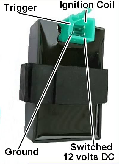

I've not seen a TaoTao 110cc wiring diagram. But the wiring on chinese quads is often similar enough between brands that you can get away without a specific diagram fro TaoTao by looking at other brand wiring diagrams.
But to narrow down which diagram to start with, does your CDI have 4 pins or 5 pins? See below:
