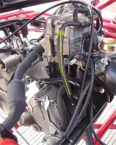

OK, so went to 45 pilot and 122 main and ran much better. It will still die when I come to a stop, but will idle once I restart and then once I slow to a stop again it will die. Played with fuel screw and could not improve.
Went to a 48 pilot but after reinstalling the carb, i noticed this hose was disonnected. See photo as disconnected at yellow arrow. It than ran worse. Unsure if due to 48 or reconnecting hose. Did not have to much time to mess with it.
http://i1097.photobucket.com/albums/...oser/pict2.jpg
Would that hose effect fuel/air?
Also where it T's up in the middle and connects at 2 spots, the middle T connects to a long hose that just hangs down, so it might be a slightly different cn250 version.
Thanks, as I seem soooooo close to be dialed in.
Jason
Old Aug 3, 2011 | 09:09 AM
mywifesquad's Avatar
KTM Patrol
Former Chinese POW!
Joined: Jul 2004
Posts: 78,507
Likes: 56
From: Hat Creek, Ca
As long as that hose doesnt connect to the carb or intake manifold it shouldn't affect anything.. What does all that plumbing connect together?
