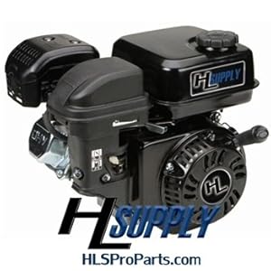

Their are plenty of clone Honda Gx200 motors made to the exact specs but in no way are the made of the same materials or electrics. Price and reliability will reflect that.

The real thing.
Clone
