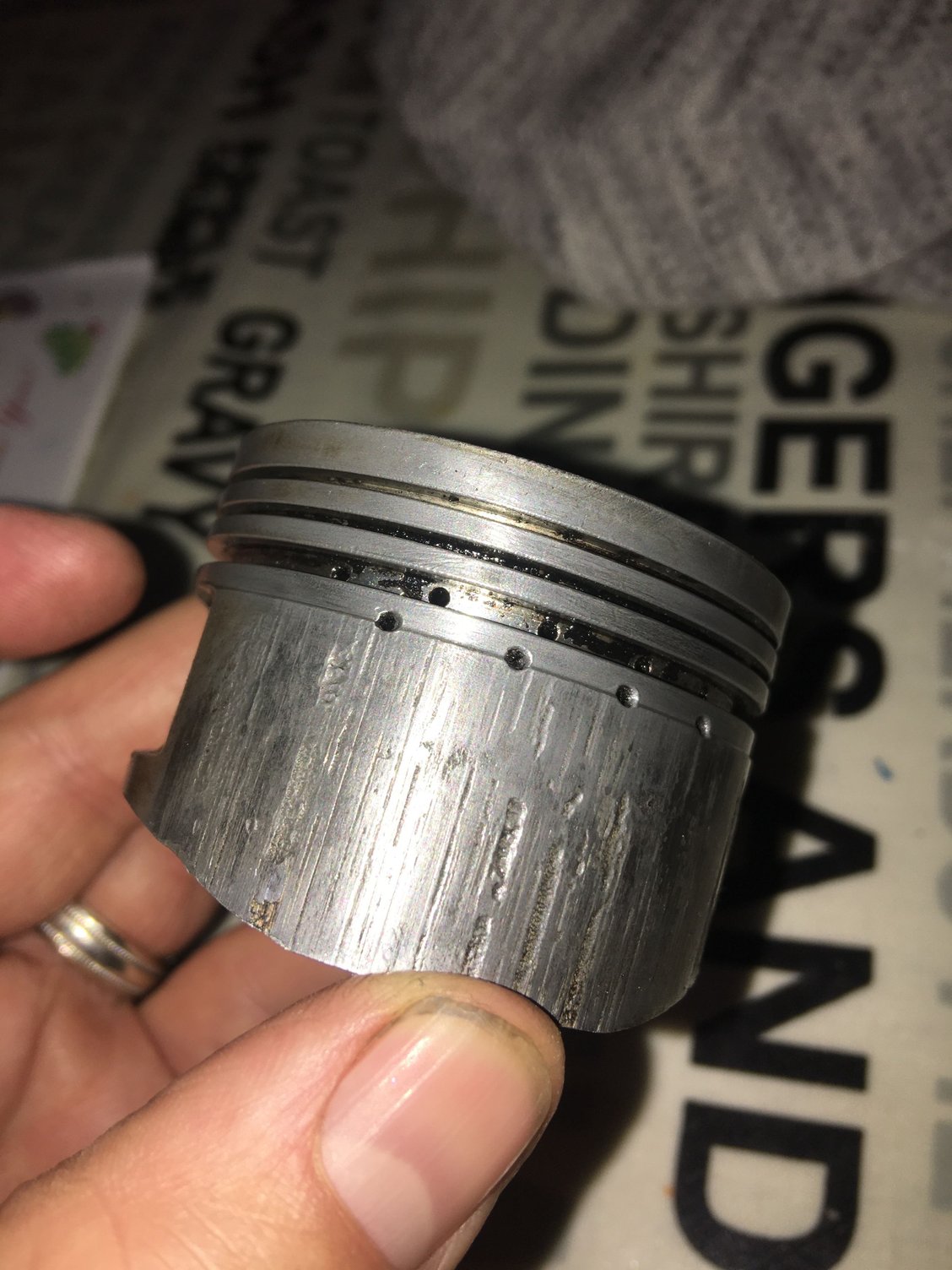

Old Dec 10, 2020 | 10:25 AM
allybarrie's Avatar
Joined: Dec 2020
Posts: 7
Separately, would anyone say reinstalling this is ok since the scores are below the rings? I’m minded just to change it.
