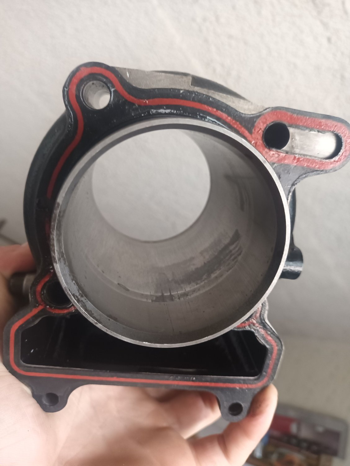

thanks for the quick reply, now I opened the valve cover and came across these small cracks, I don't know if this is correct or not, under number 1 I marked that it is not original, I know number 2, but I don't know if it is original or not, that it is a hole, so I am attaching one picture from of the valve cover, which shows a small crack next to it, I will add 2 pictures of the cylinder, thanks again

I can't tell much from pictures, only you can judge if the cracks are going to cause problems with leaking oil and compression. The cylinder has had moisture in it, causing a bit of rust, but I recon that when you hone it, it will come up good enough to re-use.
