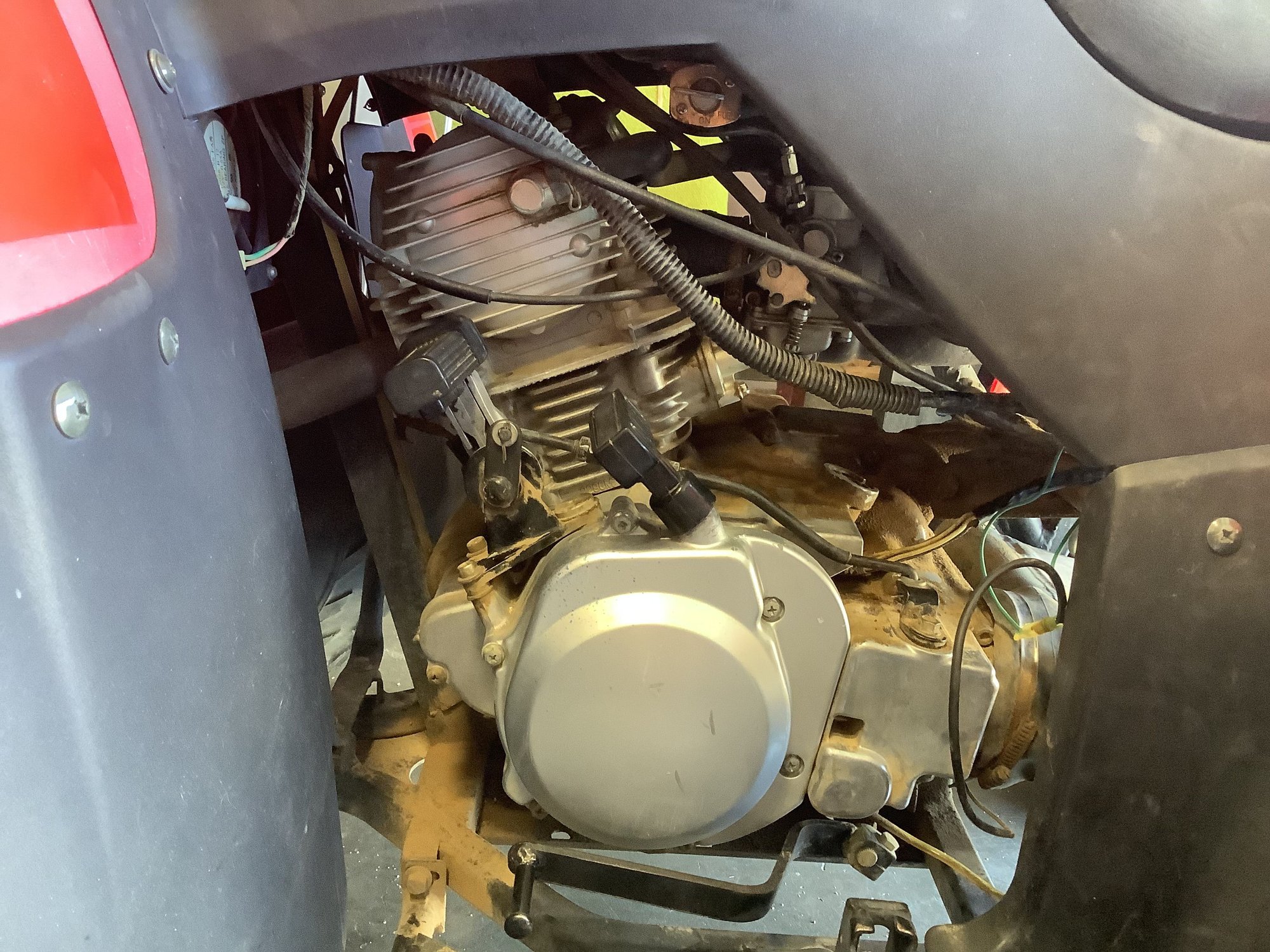

Hi everyone, first post here. I just got an unknown Chinese 250 quad that got started yesterday with a new battery. After riding for about 10 minutes, the engine stopped. I noticed the ignition coil wire was stuck to the engine and melted through. My friend who is a mechanic said there is no spark getting to the wire now. He told me to get a new cdi box and ignition coil. After doing some research, I noticed my cdi box is unlike the common three, and I have no idea what manufacturer or type of clone my quad is.
Any help identifying the manufacturer or type of clone this is, or which cdi box I have, would be a huge help!
Only marking I found is vin

The box looks a lot like the "ignitor" someone else on here was after last week, but I can't see why you would need to buy new everything because the coil wire shorted out. Pic of a Ram's head on the front may indicate bike is a Quadzilla RAM, but telling us the vin number or putting it into an on-line VIN decoder would help with identification
