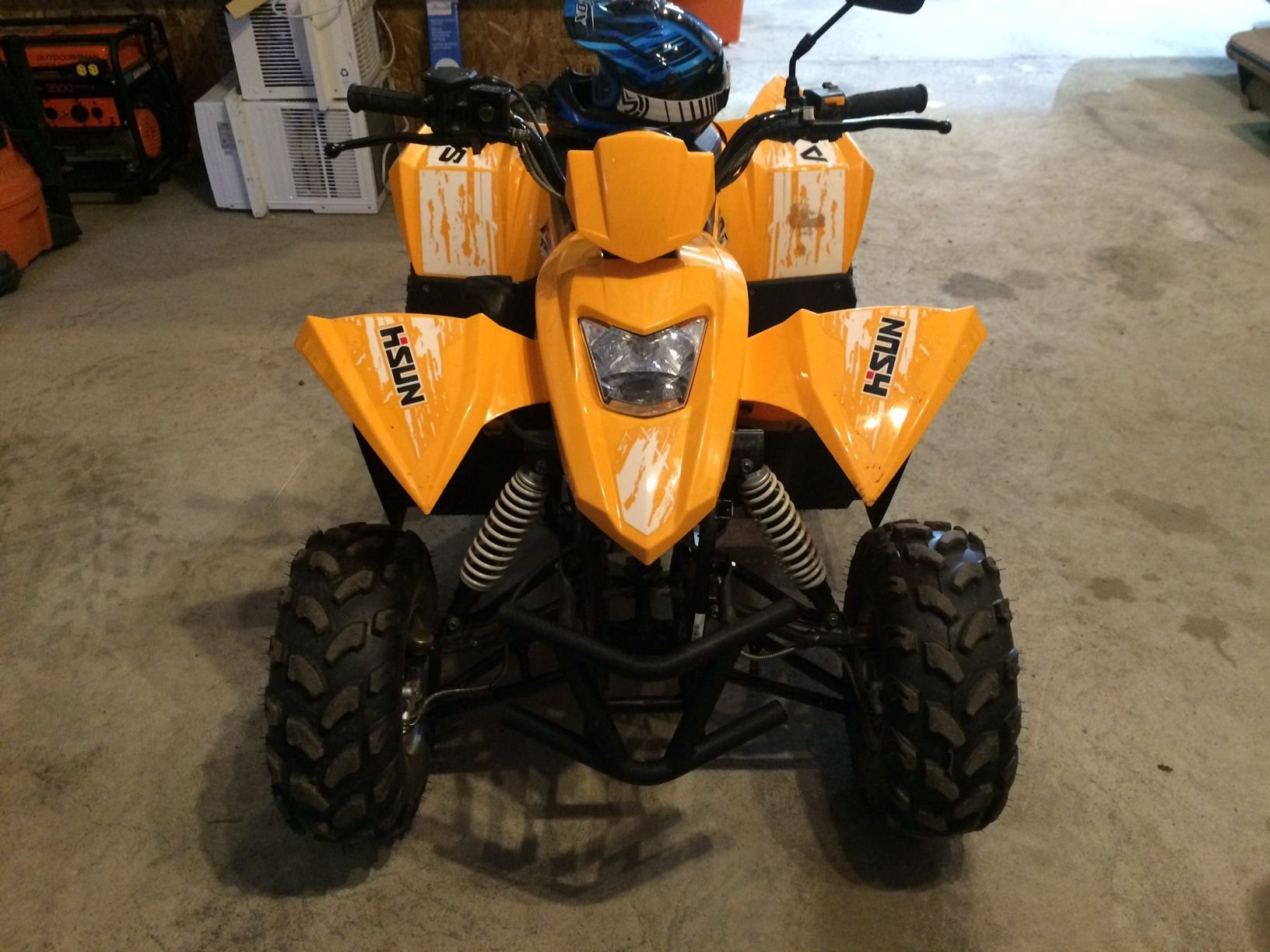

Posts are more fun with pictures.
My daughters Axis 110. This one smoked the drive belt at 124 miles. Dealer mechanic thinks it wasn't ridden hard enough and the belt got glazed. Possible I guess, my daughter is pretty gentle with it.
