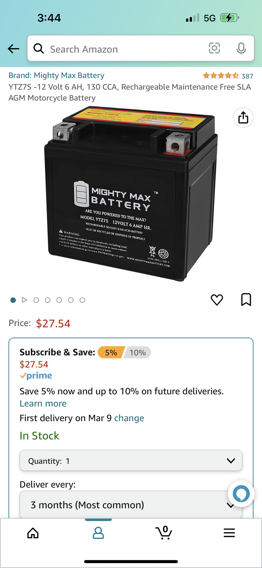

it was only after I got it home, giddy with such a cheap buy, that I learned he left out the fact that the thing looks like it had burned through its factory battery, was replaced with a Walmart, and had boiled it as well.
The same issues I see bunch of people posting about… charging upwards of 17volts PLUS, with no end in sight!

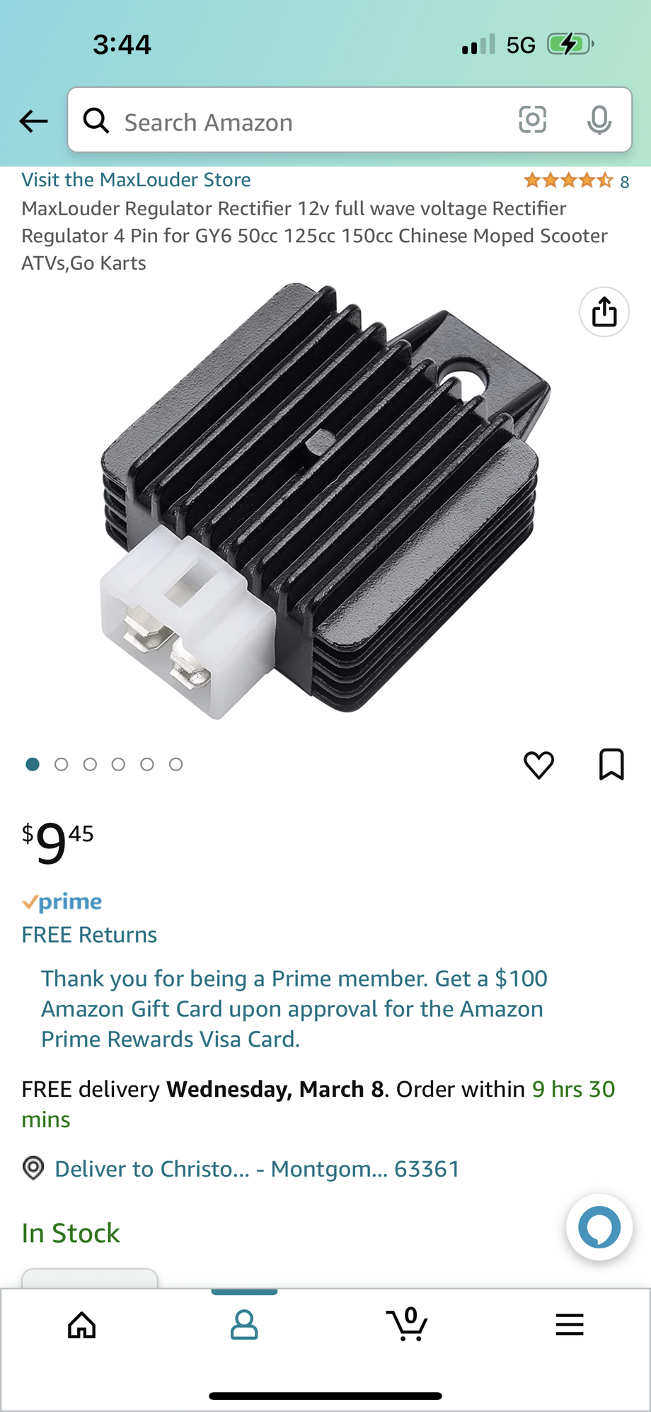

First, purchase THIS RR UNIT. I tried every damn one on Amazonand THIS is the only one that works “correctly”. I did try a buck converter as another fella posted, and while it did work good, and allowed me to adjust the charging voltage, I really didn’t want another thing on the bike that would have to be diagnosed later if something went awry.

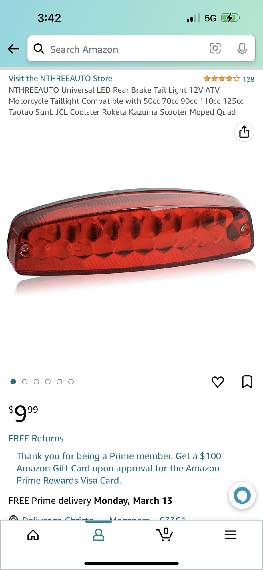

On that note, buy THIS tail light. Again with the amp draw thing. I tried tons of things… this is the one.
I actually made a home brew light, but my tail light build has the same amp draws as this one, and I tested this one on my setup, and it worked just fine.

Next, stab in ur replacement RR.
Finally, replace your headlights and tail light with the aforementioned led’s.

Tail is pretty simple. If u got this far, you’ll be fine. But, just in case, green/yellow is the BRAKE +12.

The problem was the alternator is producing too much power for the rectifier system fitted. Not sure those little silver ones used as standard actually did any regulating, certainly regulators are supposed to limit volts to 14.5v but they were not doing so, therefore it was a regulator problem. Looks like you landed lucky with that Amazon regulator, there were lots of posters back round 2016 who bought new "regulators" which didn't cure the problem. It may have been a mismatch between single and three phase regulators. Note there is a coil on your diagram, in the stator, between the yellow and earth, making it (sort of) three phase, using earth as the third phase wire.
