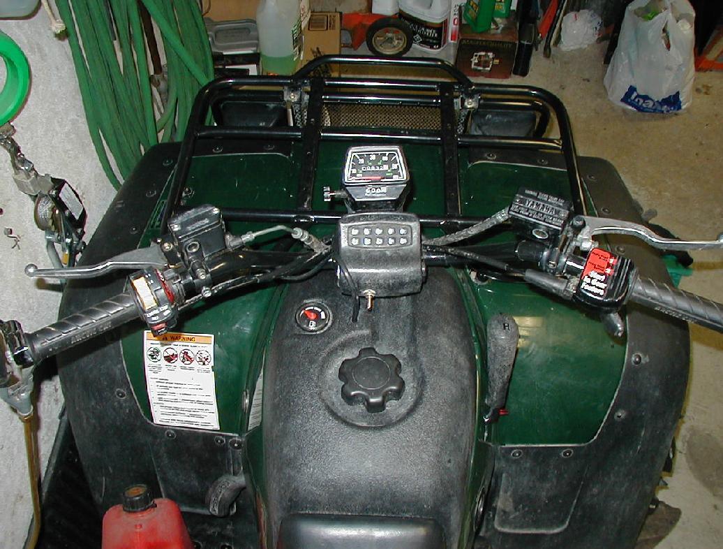

Old Dec 7, 2002 | 12:25 PM
GerrBear's Avatar
Joined: Dec 2000
Posts: 47
Default How bad is front differential on the cat
Zookin,
Splitting the two front brakes works. I tried this last spring on my 2001 AC500. The first time my bike 3-wheeled, a bit of pressure on the wheel that was spinning and the front end locked up! I didn't cut any brake lines to do this. The only mod I made was blocking off the right side banjo fitting with a fine thread bolt & crush washers. This way I could return the bike to stock in little time. I do not recommend this mod as braking characteristics will be affected. I'm used to the new(and awkward) braking system now and do not lend my bike out to anyone for this reason.
Here's a pic showing the 2 levers. The one I added on the right is a Yamaha master cylinder! => Levers
