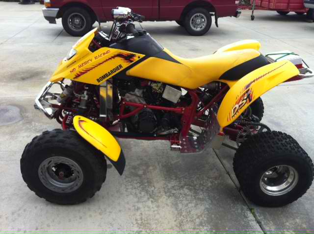

big rays ds 1000

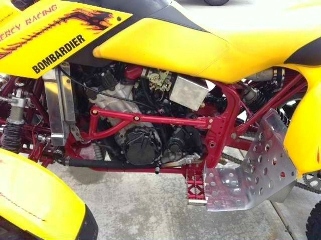

big rays ds 1000

Thanks TLC, nice vid. Big Ray nice quad, how does it perform with the elbow you are using at the intake for the throttle bodies? Is that something you made? Looks good, with that you are able to use the stock fuel tank.

BigRay is using the stock tank. He did mke the throttle bodies.

I did make the elbows to turn the injectors down. the bike is being dyno tuned this weekend by Tudors performace in corona ca,
