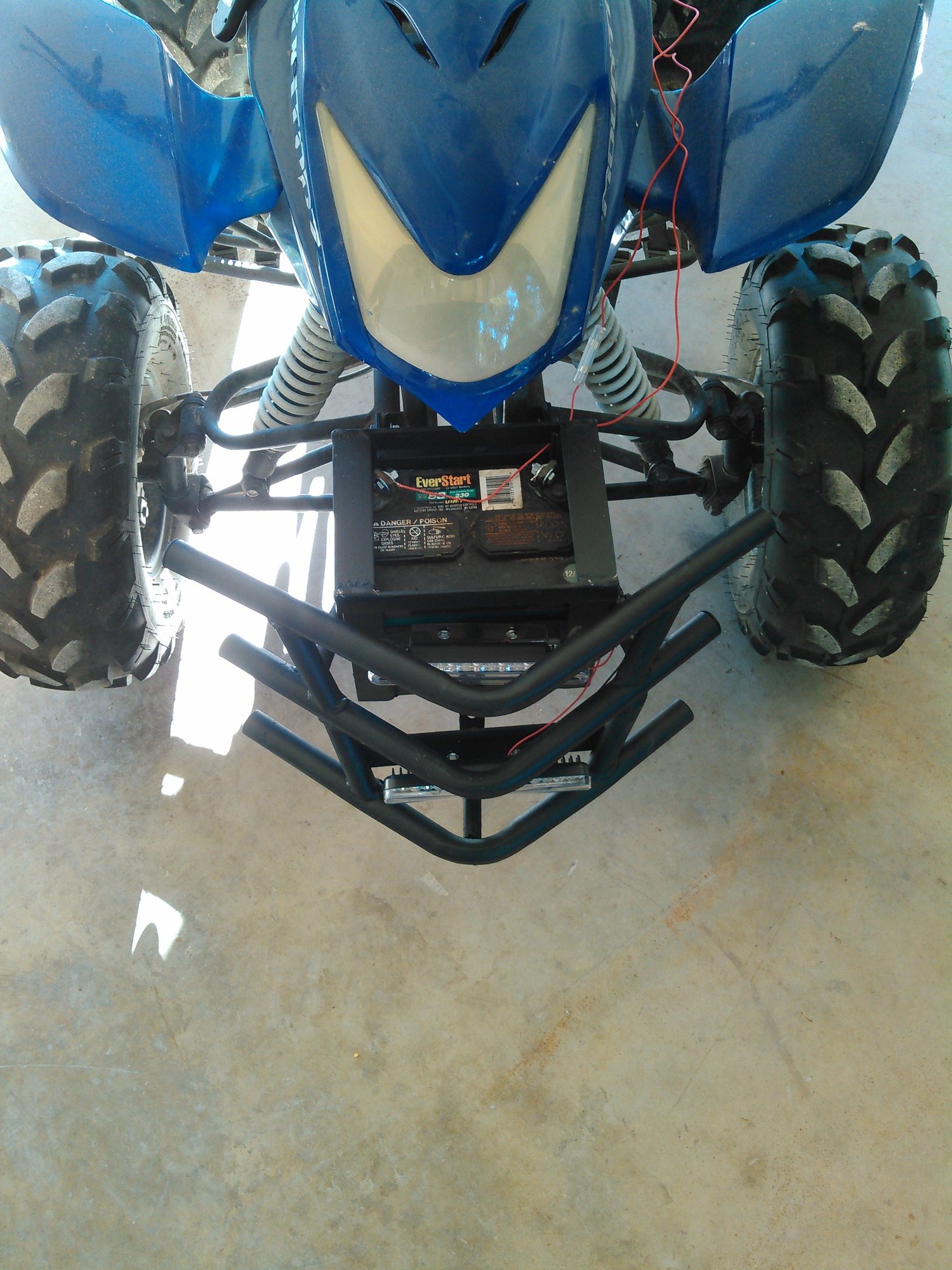

Turned out pretty good. A piece of aluminum diamond plate on top of the battery cover will finish it off.
All lit up.

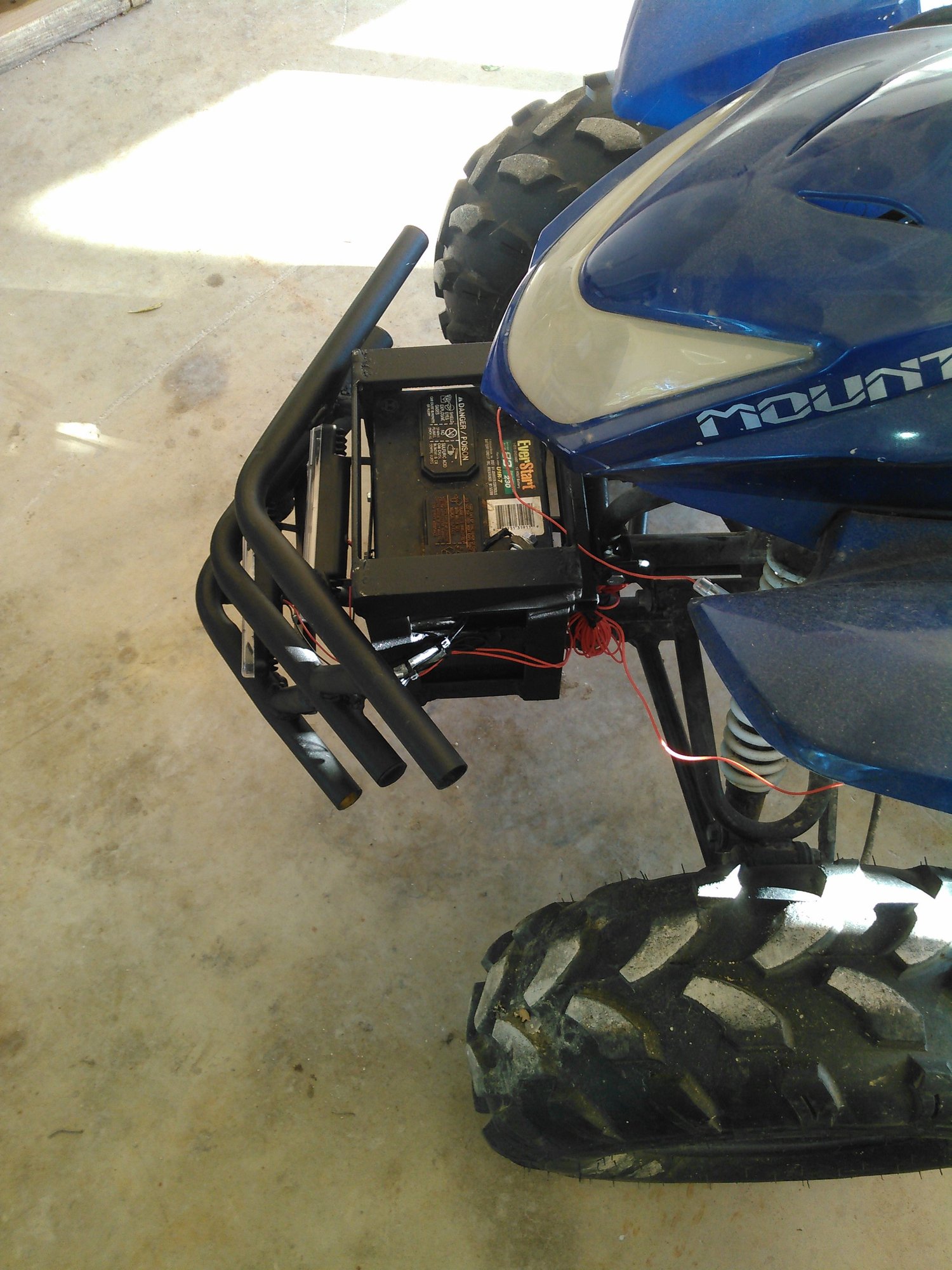

Crash bar mounted to front of box.
Box trial mounted after being sprayed with truck bed liner.

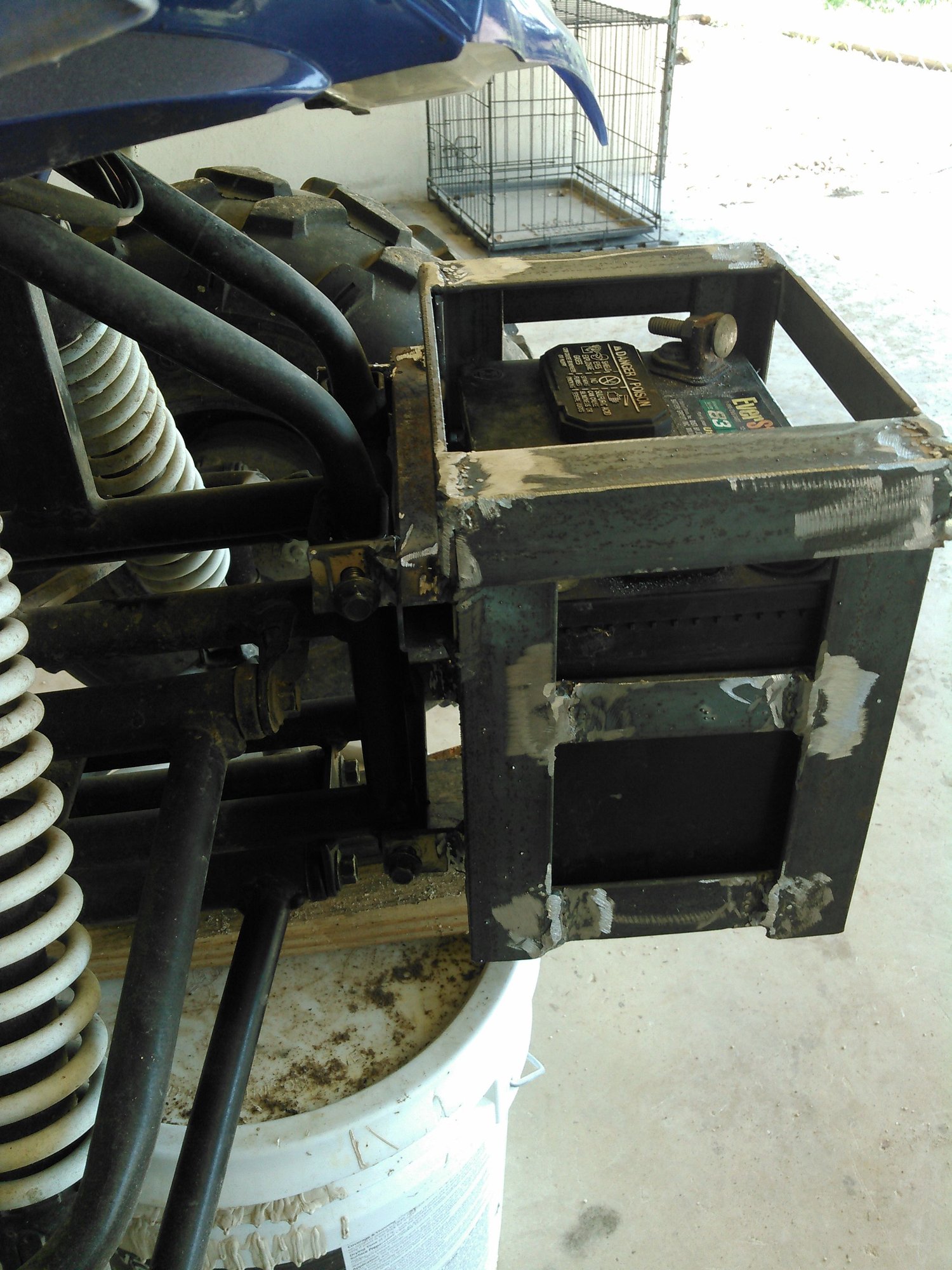

Side view. Box uses existing bumper mounts

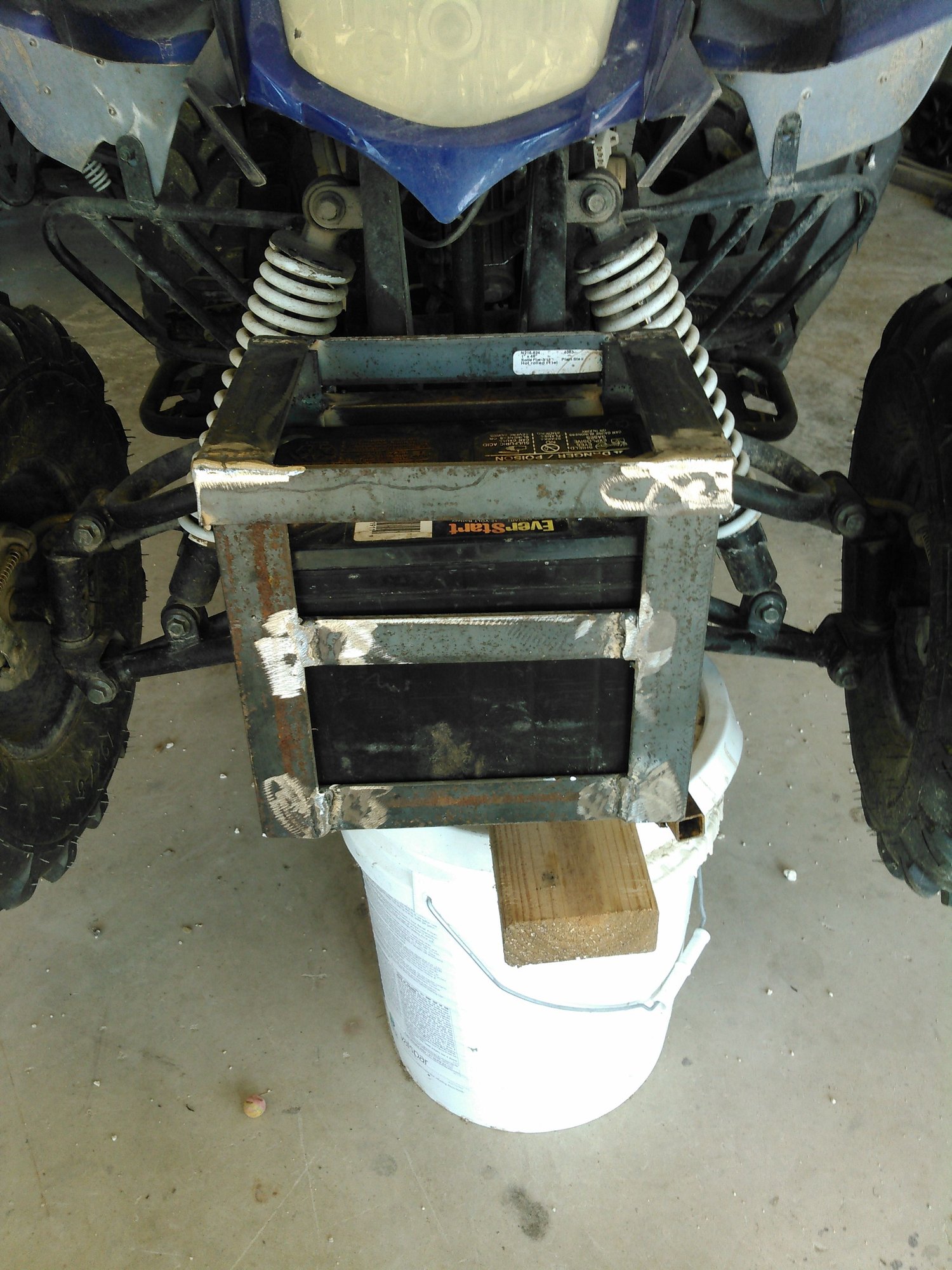

Box welded up and trial fit.
The stock headlights on my boy's quad was weak and the clear lens has started to yellow, so I've wanted to add an LED light system to brighten things up. My worry was that the starting battery wouldn't be enough to keep up with the current demands, so I decided that an auxiliary battery would be the way to go.
While planning a mounting location, I realized that an additional 20lbs over the front wheels would help to calm down the overly stiff front suspension.
I came up with this battery box that bolts to the front crash bar mounts, then I modified the crash bar and welded it to the battery box.
I used 1.25" angle iron and some flat stock I had laying around. Came out pretty good.
