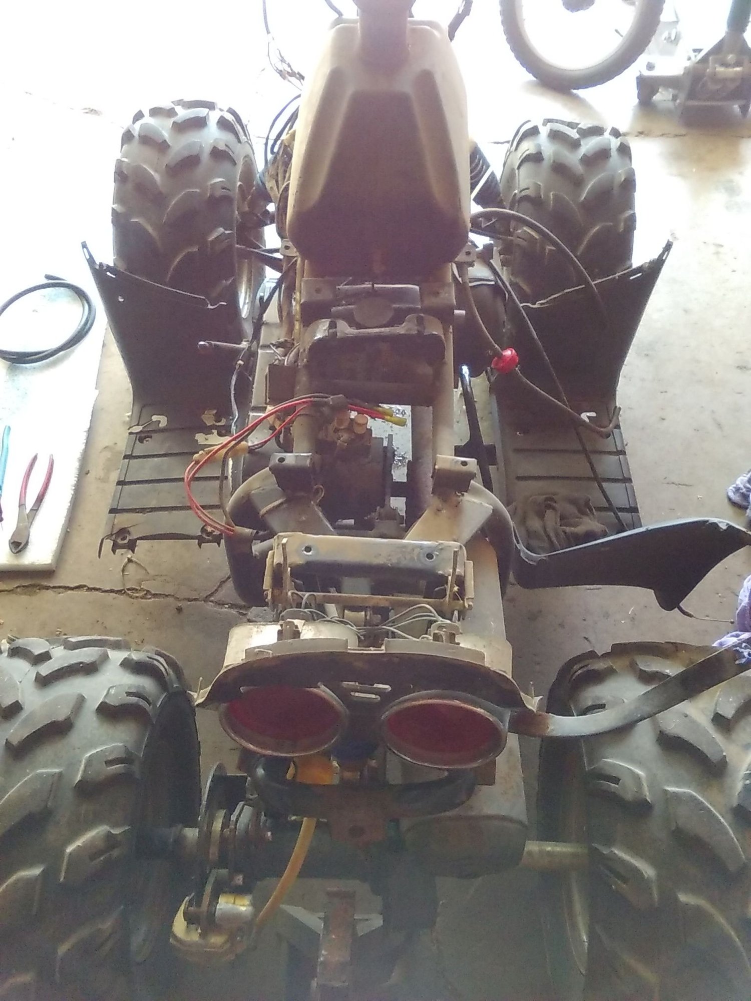

Old Aug 1, 2016 | 01:18 PM
Mikevavrik's Avatar
Joined: Jul 2016
Posts: 6
Default Some pictures of what I am deling with
Old Aug 2, 2016 | 01:55 AM
Posts: 7,487
Likes: 387
Most of these 90cc two strokes have an electric choke, you haven't mentioned if the new carb has, or if it is connected. You did mention a disconnected "fuel valve," what is that?
Old Aug 2, 2016 | 06:50 AM
Mikevavrik's Avatar
Joined: Jul 2016
Posts: 6
Yes, electronic choke is connected. Fuel valve is the valve controlling the main, reserve and off positions from the tank. I bypassed it to go right from the tank to carb.
