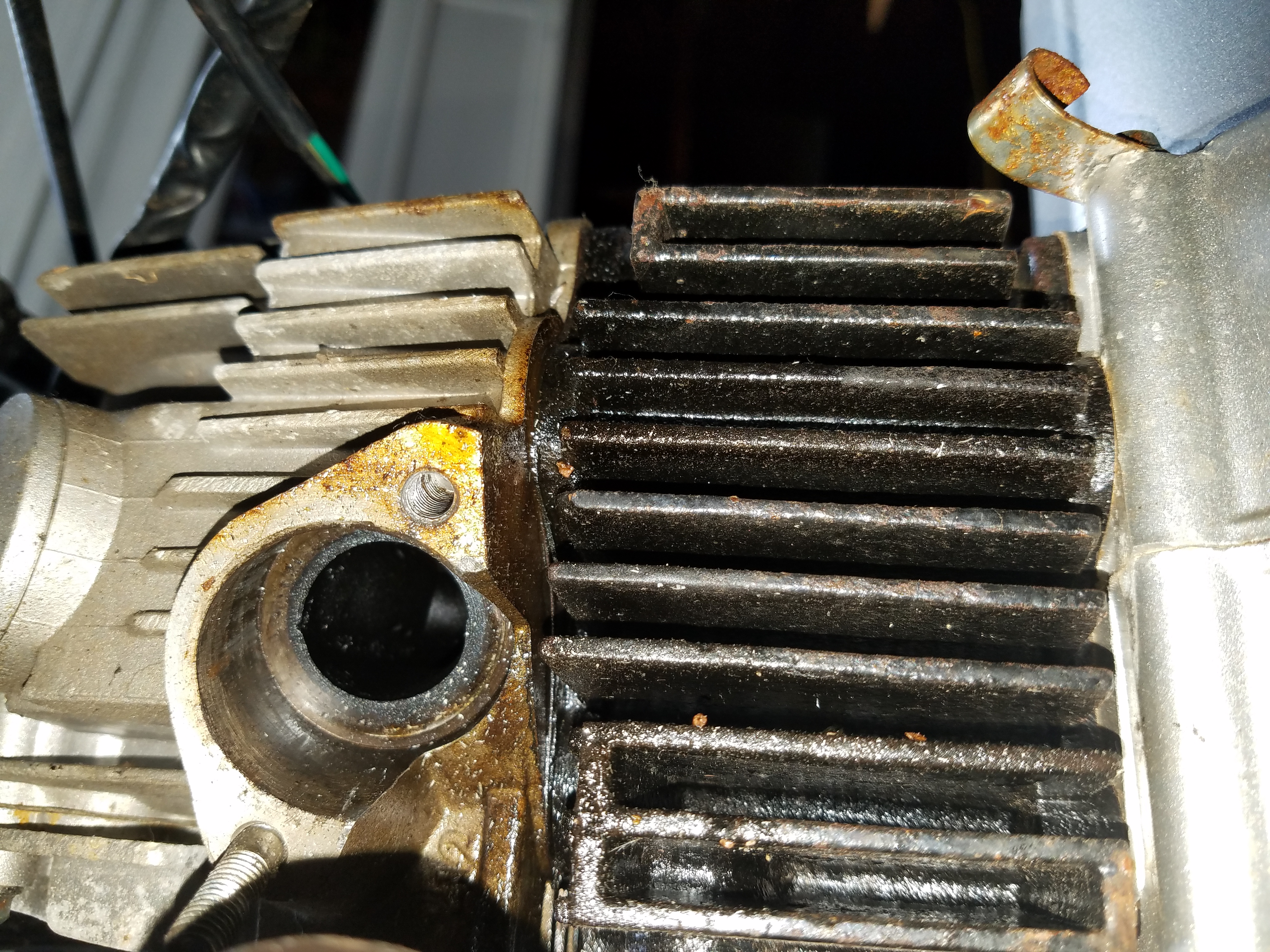

Is this normal - half of the 1 side missing? It looks like a piece has been cracked off. What would the seal look like for this?
If this piece is damaged whats the piece called so I can replace it? Thanks

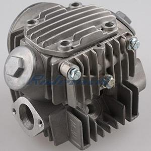

Here are other pics os the replacement piece needed - silver piece all the way to the right and to the left (same piece different views)

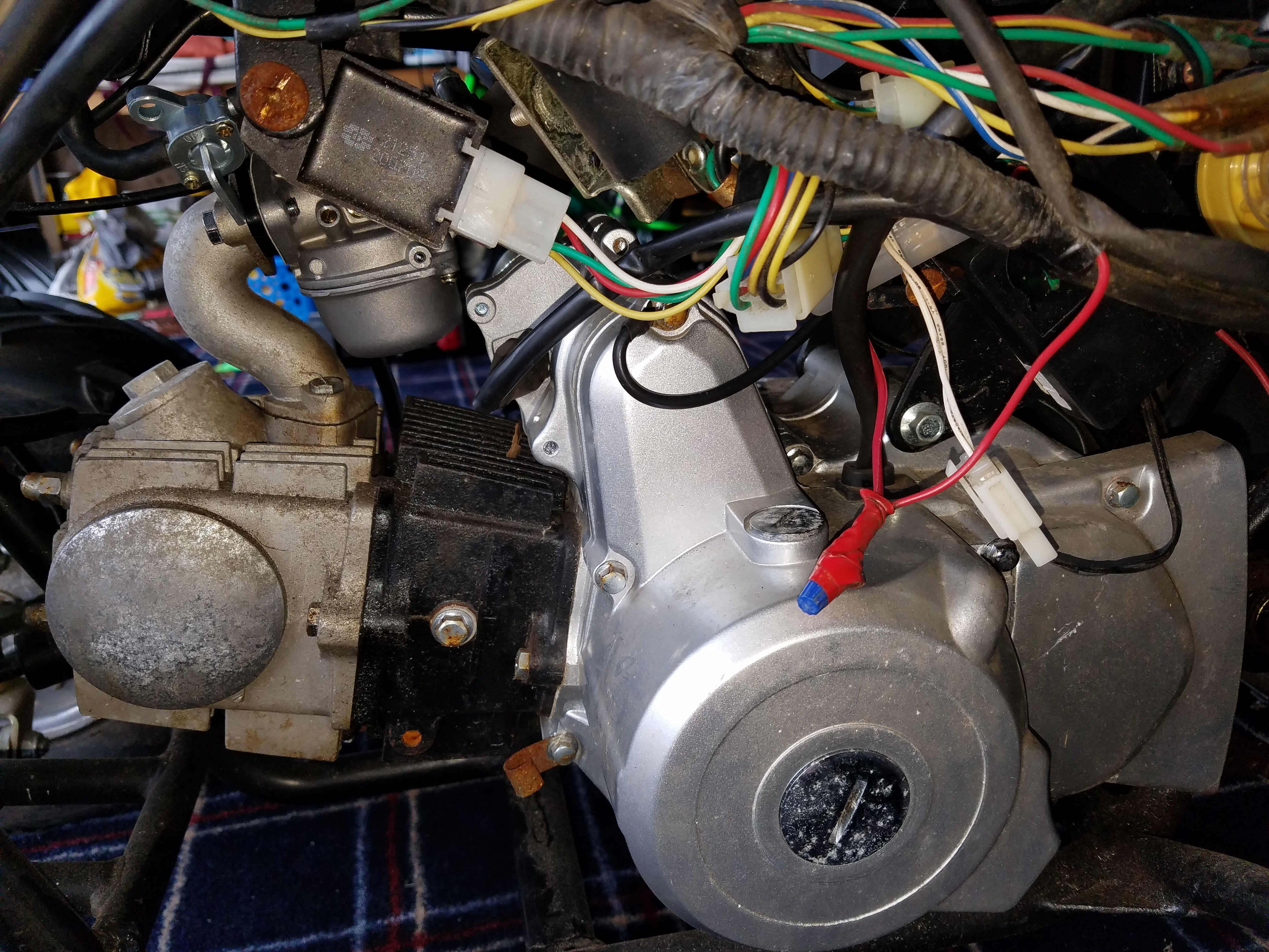

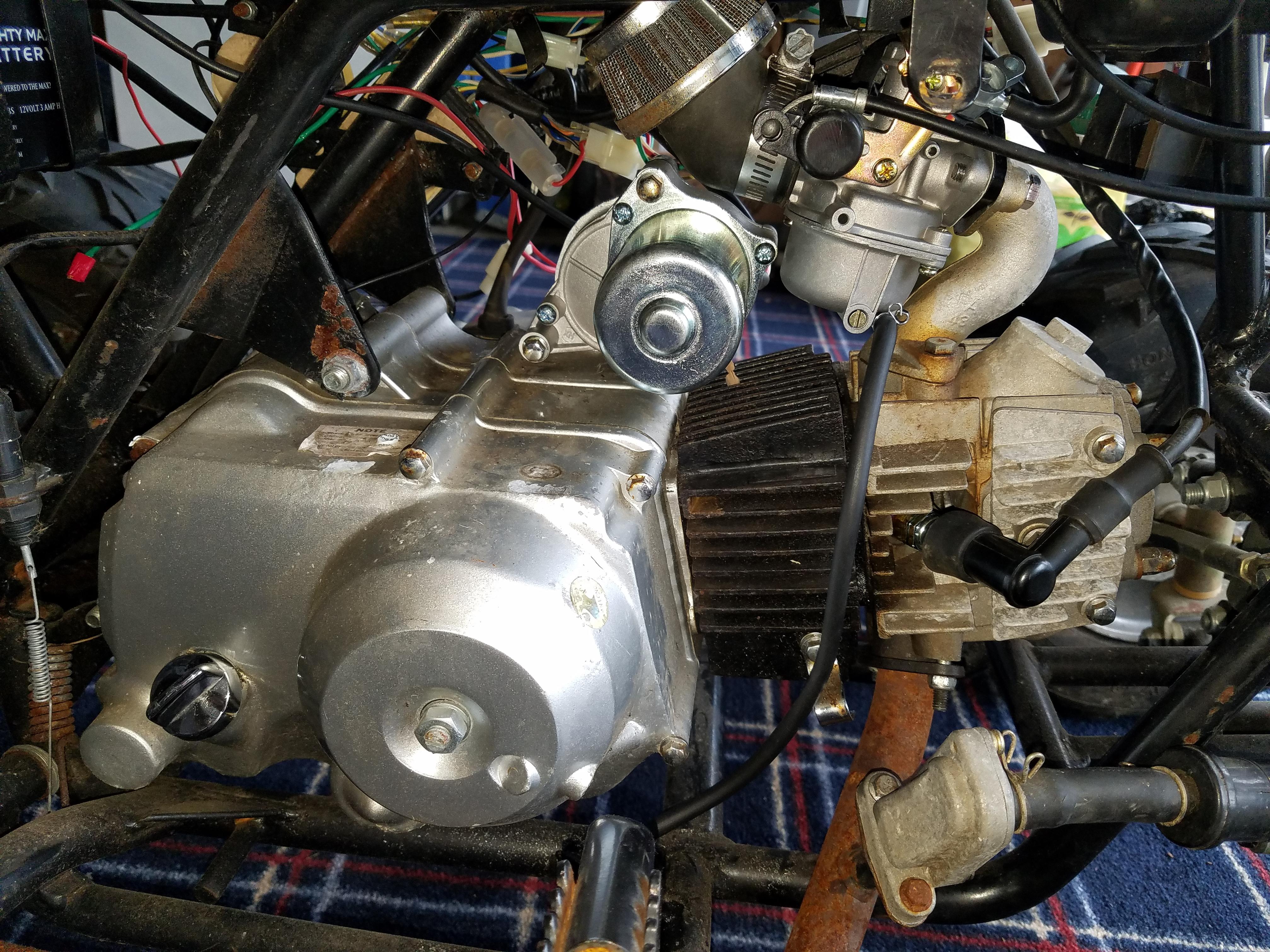

Shouldn't the 1st pic look like this in regards to exhaust connection

Recon you last pic is the inlet side of the cylinder head. Yes, there may be a bit broken off, but there is a complete circle of exhaust port where the sealing ring sits, and the two stud holes are OK, so the broken part doesn't matter a bit. Get a sealing ring and fit it.

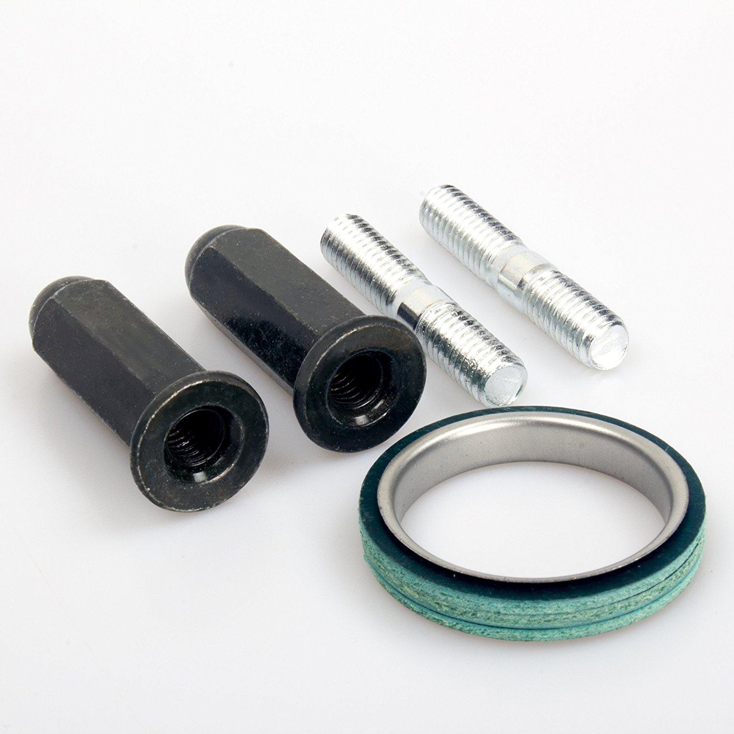

Would this be what the sealing ring looks like?

Could be, any I have seen for the Honda Cub clones is like this https://www.ebay.co.uk/itm/Seal-exhaust-around-35x43-5x5-3mm-Honda-Lead-100-SCV100-08/291967647080?fits=UKM_Make%3AHonda%7CUKM_CCM%3A110 &hash=item43faa0bd68:g2kAAOSw5YNZt5s1 but may just be from a different manufacturer.
