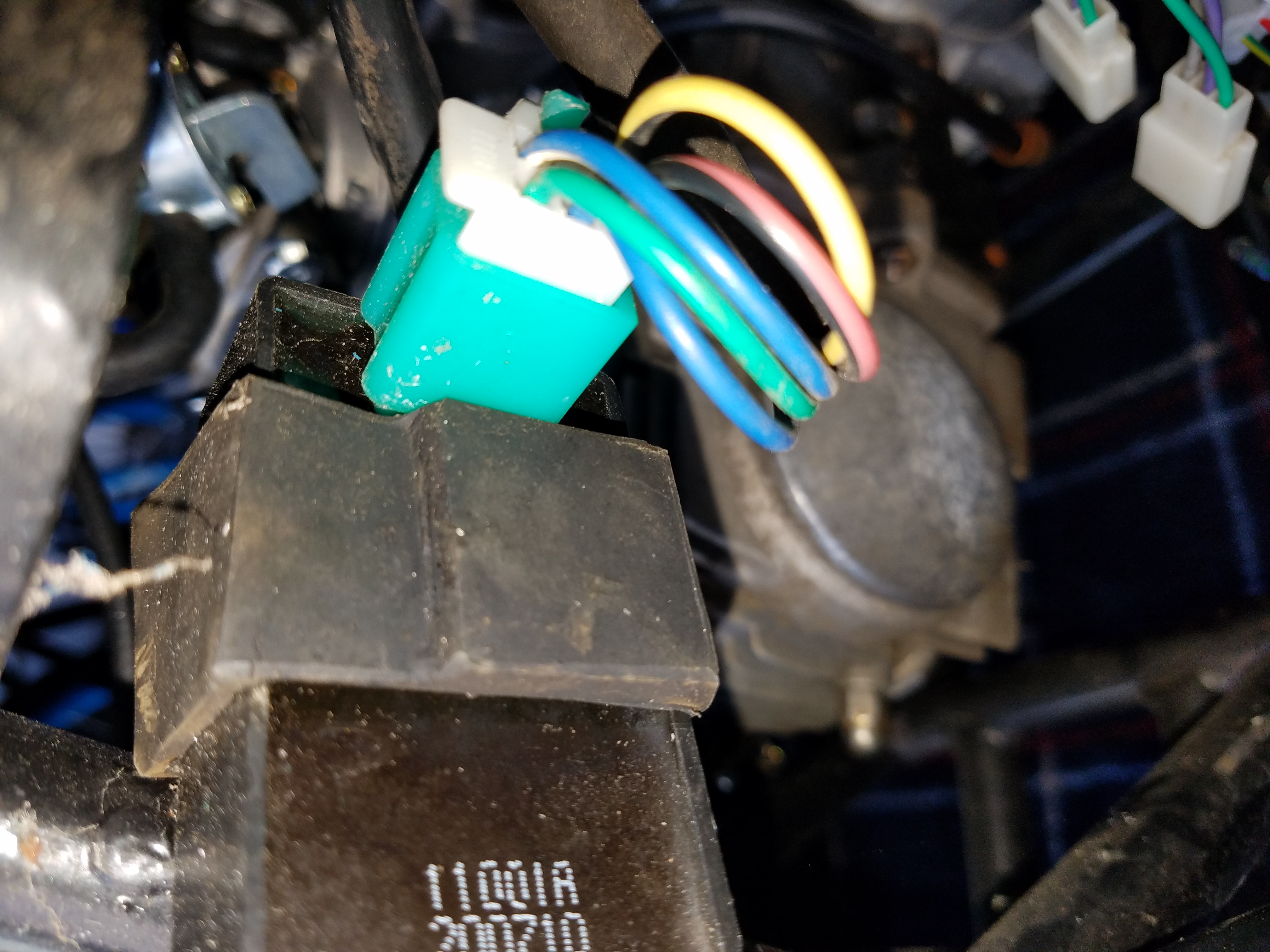

These are the color wires going to CDI
Attached Thumbnails SunL SLA-135-20180615_171247.jpg   SunL SLA-135-20180615_171243.jpg

Right no black/white. Can't find a 135 diagram on the net, but the 90 diagram shows a black/white kill wire at the ignition switch, connected to a grey, which goes to CDI, see if you can find a black/white from ignition switch and trace where it goes. My guess is the middle wire, which isn't shown properly on either photo.
