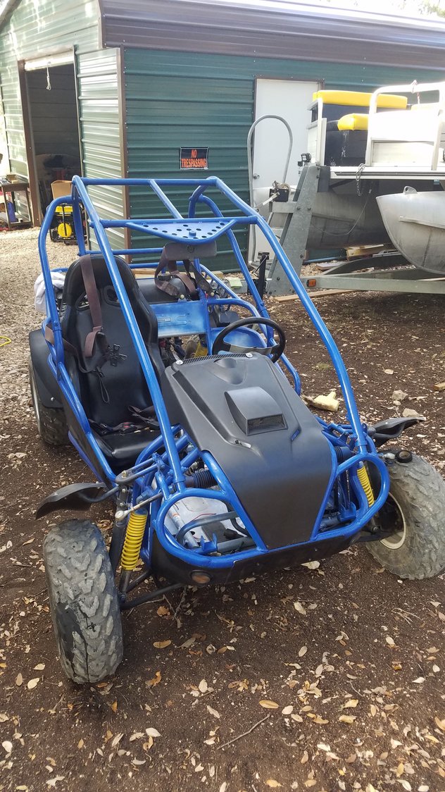

having trouble finding the year and model of my carter kart. VIN is LB415B14870000356. I think its 2007 and 150cc but body panels look like GTS 250.

Yes it is 07. Cyclepedia's vin decoder also throws this up:-
Manufacturer Name: Chongqing Yinxiang Motorcycle Group
Address: No 8 Science Industry Zone
Zip / Country / Phone: 401120 China
For engine size, you need the engine number. It is marked fairly boldly on a GY6 engine, but I can't remember just where. Low down on crankcase I think.

I haven't seen one with that exact same frame. But seeing as the previous owner painted it, they may have done some modifications to it as well.

Thanks guys! Yes I think aftermarket body panels were put on which was throwing me off on identifying it. Now my next problem is it won't start. Ran fine one day then nothing the next no power to the dash. I found this plug picture below that obviously needs work. I'm going to eliminate the plug and direct wire. My question is why does the yellow wire go to Pink and vice versa? This is wiring for regulator rectifier .

I would be cautious of removing the plug as, if you need a new regulator, you would have to re-wire it as well. I would fit a bullet or spade on the red, and leave the rest going through the plug. If the pink and yellow are from the stator coils, and not earthed, it wouldn't matter if they are reversed, sloppy manufacture though. That red will go to the battery via a fuse, and to the ignition switch. Check if the fuse has blown, also check the red that was hot hasn't shorted to earth in the regulator, if it has, it will blow the new fuse.
