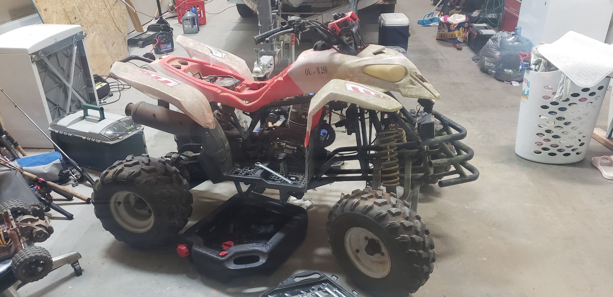

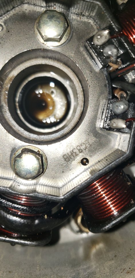

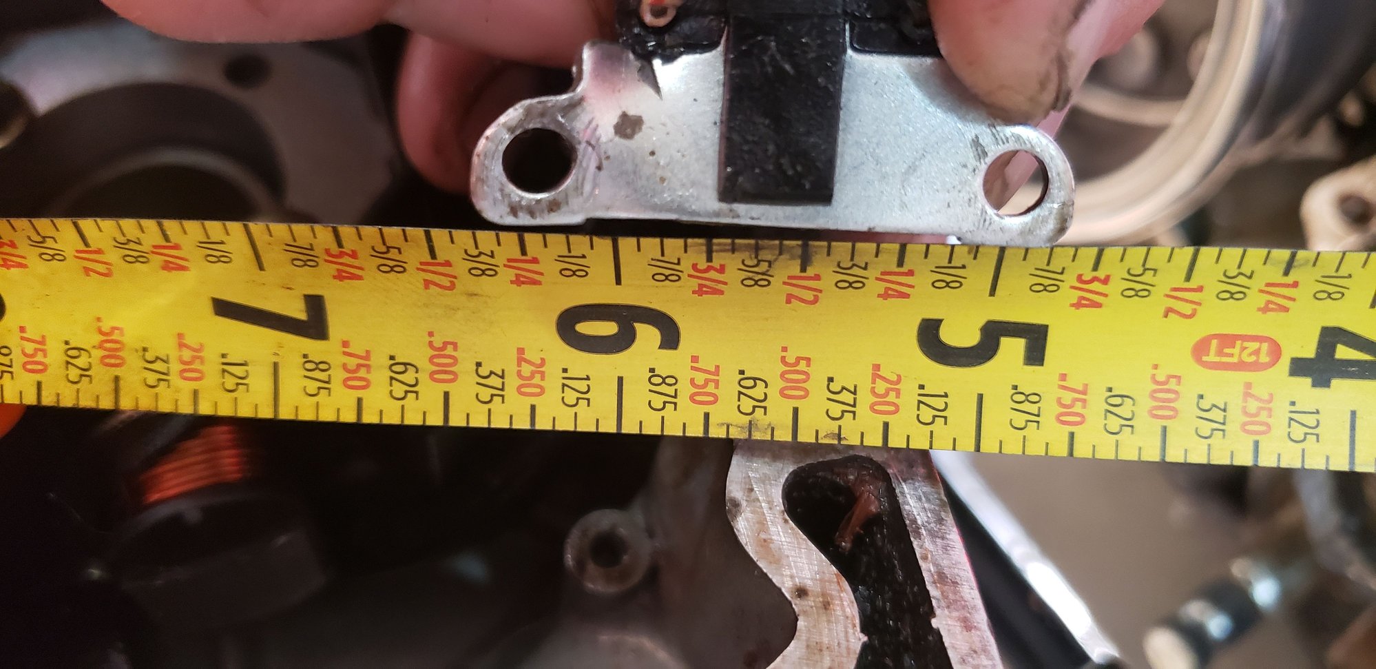

The title is all the info i can find. Its got a loncin motor on it. I bought a wiring kit off amazon and everything but the stator worked. I salvaged the old stator and had it running great. But my dumb self destroyed the old stator on the first ride because i let an alignment pin for the cover fall off inside and it ragged the stator completely. I cant find the original stator ANYWHERE online. Any help or suggestions will be appreciated and any info needed that i can maybe find on the quad can be provided.

Here are more pictures

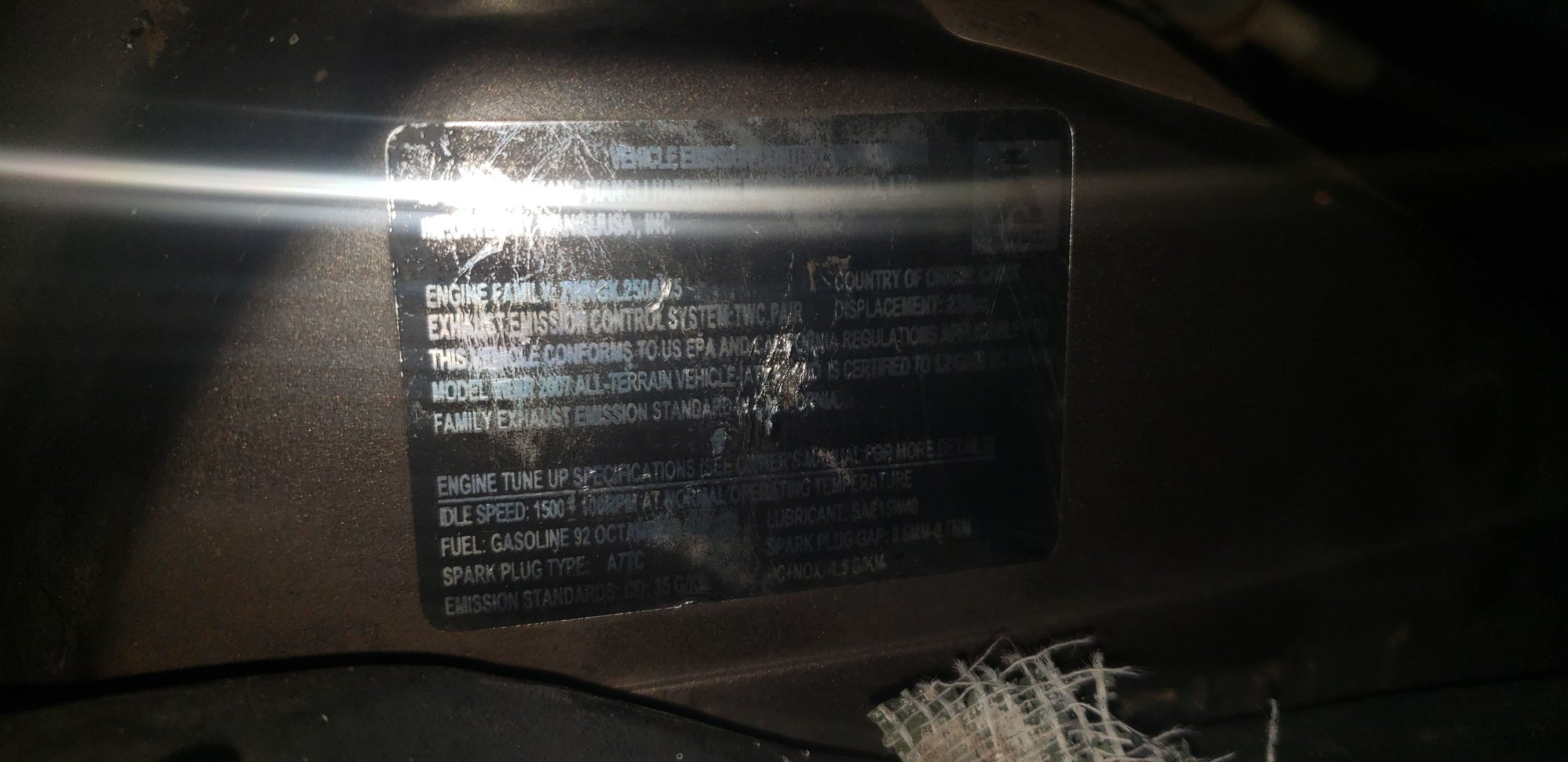

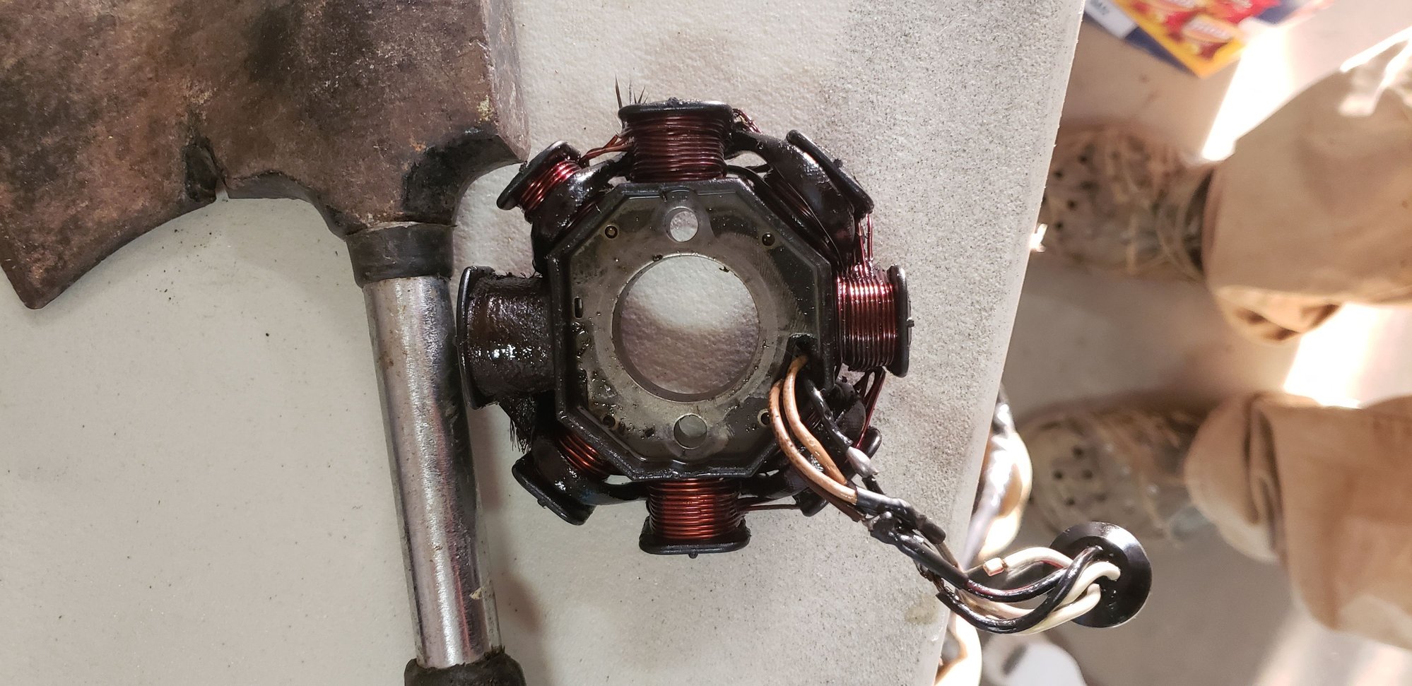

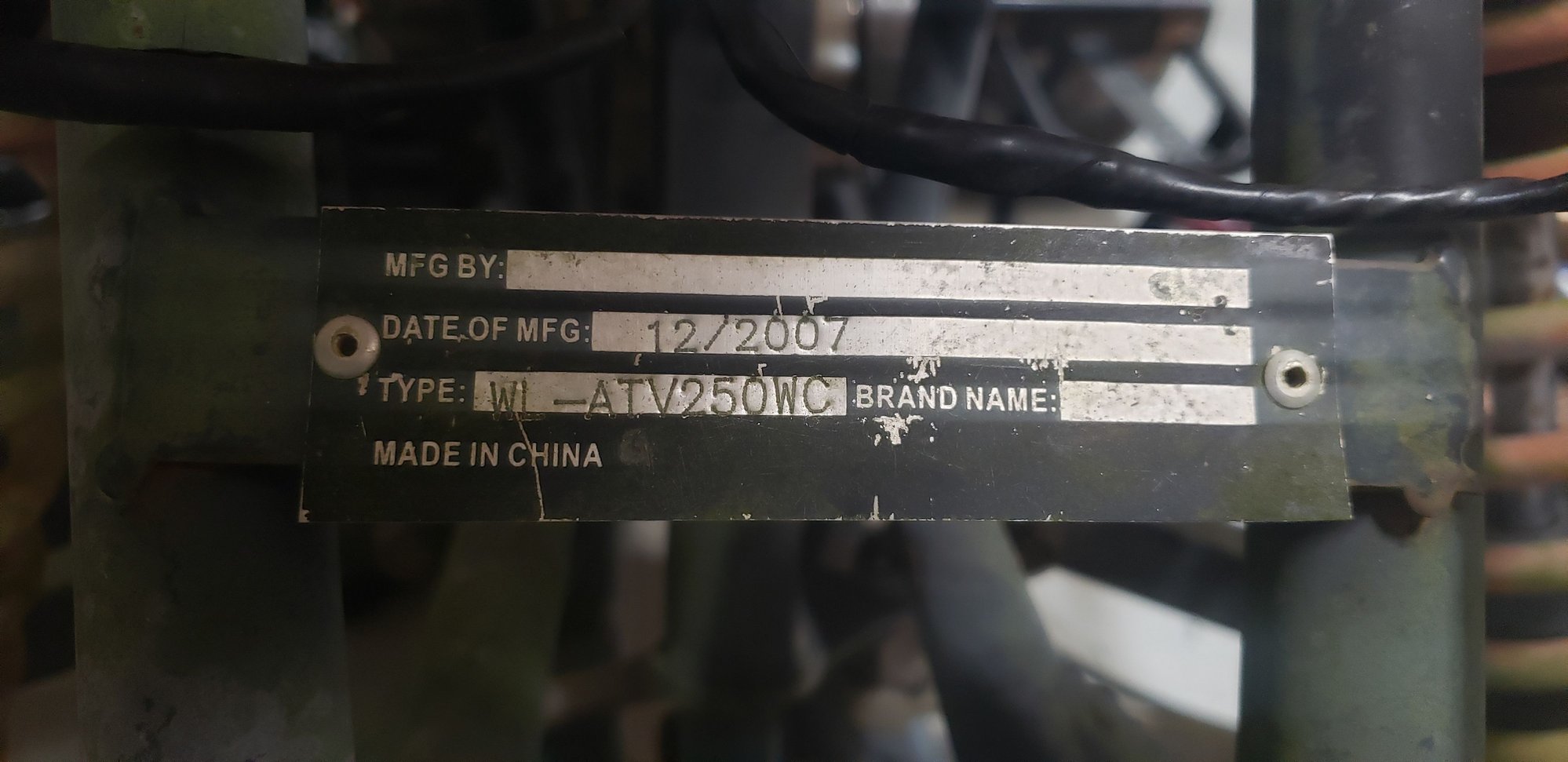

On the motor plate is says manufacturer is "wangliusa inc" cant find a vin anywhere on the thing. The old stator is trashed completely. I see a ton of stators that look like it online. But trouble is all of them have 3 mounting holes. Mine had 2. Idk if the 3 is just for different mounting applications being aftermarket parts or what. Reguardless i hate know the fourwheeler runs phenomenally and have to give up on it over a stator

OK, Googling produces a very short lived US company, who undoubtedly imported a batch, sold them and disappeared. However the clue is Wangli who are a Chinese maker, doubt if that will get us far though. So the Loncin engine, find out which Honda it is a copy of. It isn't the twin cylinder "Rebel" so google pics of Honda 250 single cyl motorcycle engines until you find a match, then google stators for that engine.

Thank you all for the help ahead of time. But the stator i got installed to produce spark is the one that came with my kit i got off amazon. i replaced the trigger coil with the one i already had to make it fit since the one that came was too wide to mount. It had 3 mount holes and my original had 2 but the 2 on it line up. Im not 100% its going to do the job properly till i get it fired. What am i looking for when looking through the spark plug hole?
