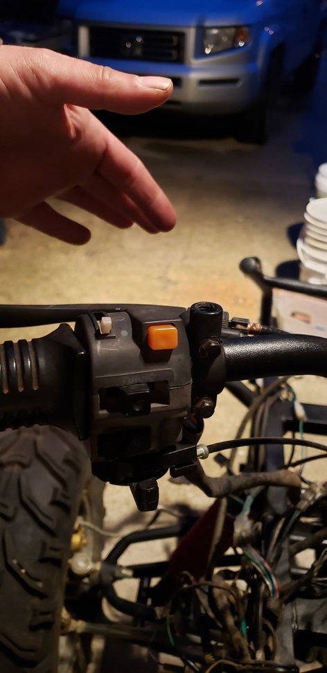

It was the start button. Was all rusted and someone had put a wedge in there to make the contacts closer. I cleaned the contacts and put it back together and it worked.

Check the kill switch first, awful close to the start button, could you have disconnected or shorted a wire there? Annoying fact is that you disturb wires when fault tracing, and can end up with another fault by the time you find the first one. Change the plug, then test wires to the CDI, the "help diagnose stator" sticky here is useful for that.

Yup. You were right! Kill switch wasnt working. I connected the two wires at the switch and plenty of spark. Yay! And the switch is now working. The issue now is a carb problem. It is revving like crazy. Even with the choke on full. I pulled out the cable and re seated the pin but it's still revving crazy high. I did clean the carb out awhile ago. And put a air filter on. Any recommendations?
