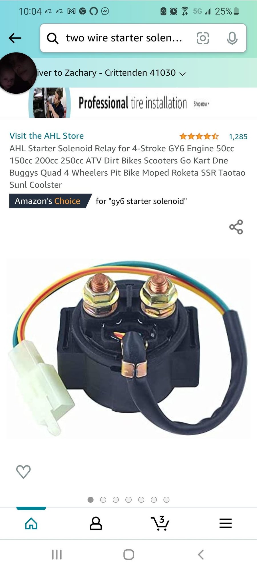

I also tried looking it up and couldn't find much. I will post a picture of the solenoid starter I need, The numbers on it are too messed up for me to get the number off it. I ordered one of amazon but turned out to be wrong.

That is a standard "Honda" type with a different plug on the wires. You may be able to get one with the right plug on it, but if I haven't the right one in stock, I chop the wire on the old one near the solenoid body and at the plug on the new solenoid, and join the old wires to the new.
Are you sure it is the solenoid at fault? I always check with a 12v test lamp. With it all connected up, put a test lamp between the thick wire connected to the starter motor, and earth. Switch on, press solenoid, if it clicks but lamp doesn't light, faulty solenoid. If it clicks and lamp lights, faulty starter motor. If it doesn't click, put the lamp onto the thin wires and see if it lights when you press the start button. If it doesn't you have a wiring fault and the solenoid is OK.

Amazon has them around $6. Have like three laying in parts bin. Wire colors wont match but has same exact connector.
