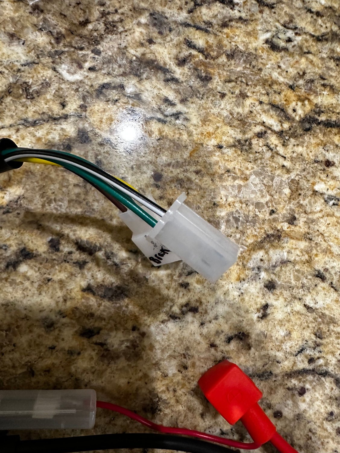

I was able to go through this harness and label all the connections accordingly, however i was left with 2 connectors that I dont know what they are supposed to connect to
1) green with black/white Called flameout, i think this is for a tether can i leave it just hanging there or does some sort of bypass need to be done?

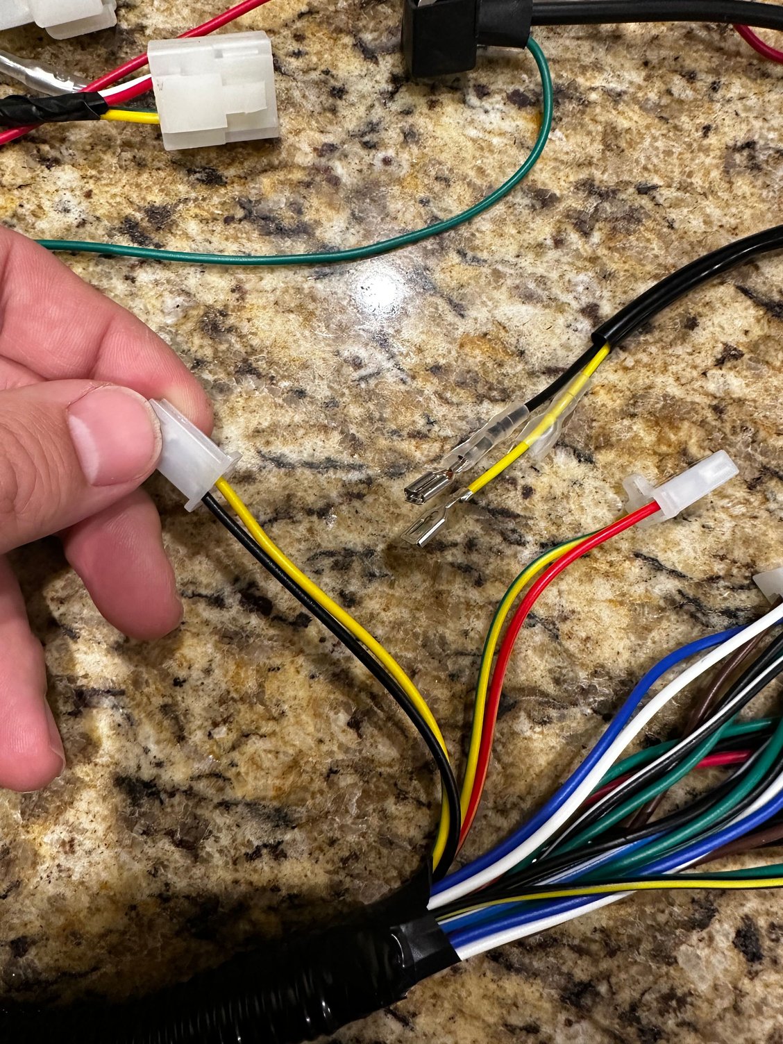

2) Black with yellow/green I have no clue what this wire is for and the schematic doesnt have it labeled. Any ideas?

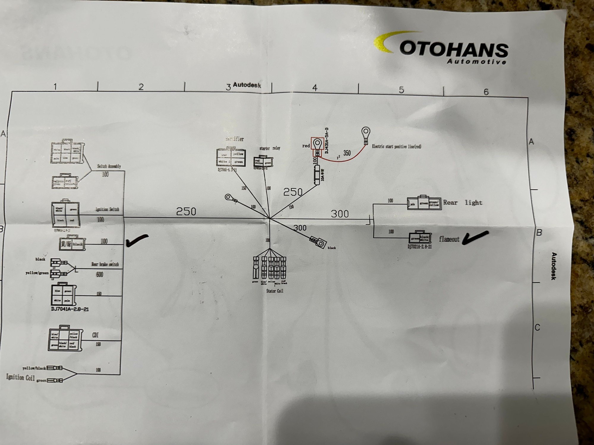

i attached the wire diagram for reference.
Flameout, does this have to be connected to something
What would this wire connect to?

I hate those wiring diagrams, why can't they use the standard type, so you can trace each wire back to where it comes from? Anyway the drawing does show a yellow/green and a black, going to the rear brake light switch, so I would guess that is for a brake light switch too. Bell them out against those spade connectors of the same colour, to check.
Kill wires on most bikes should be left disconnected to run and connected to stop. ETons and some DC CDIs are the opposite though.
