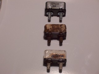

Circuit breaker in a sealed pouch up from the battery. See if power is going in and out on the red wire. If not,slice the pouch open and replace this 20 amp breaker. They can short out,corrode over time.Any auto supply will have them. You can have the key on and pull start these old machines because they are magneto triggered. The battery is for the starter, lights,fans,etc.
